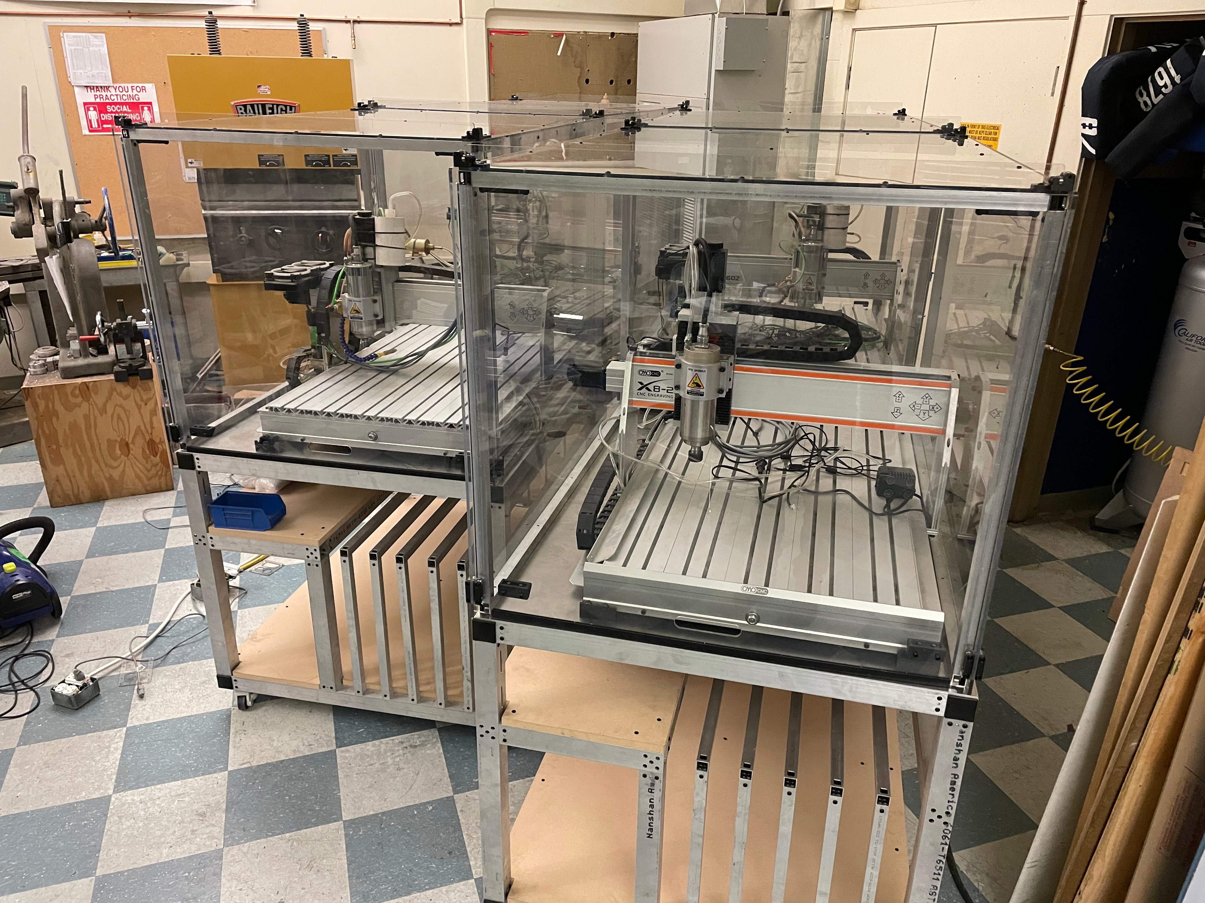

RC can probably help you out here. We just got our tube jigs from WCP yesterday but haven’t had time to set them up. We did set up our four enclosures yesterday, and we couldn’t be more happy with them!

The working area of the machine is 565mm (about 22 1/4 inches) wide. The tube jig is 3.375" wide. I know the jig sits inside the working area (we accidentally broke a bit on the side stop when first using it… oops!). So, my back of the napkin math says to cut the sheets maybe 17.5" wide to use the whole sheet (There’s additional room to hang off the side outside the working area if needed, too!). That allows for up to 1" on the other side of the tube jig, and it’s certainly no more than that.
If you get your sheets in pre-cut sizes (for example, the local shop here sells them in 4’x12’ sheets), then it may make sense to look for a an even split and give up a little working area. So using my local sources, it makes sense to cut them at 16", as that goes evenly into 4’.
