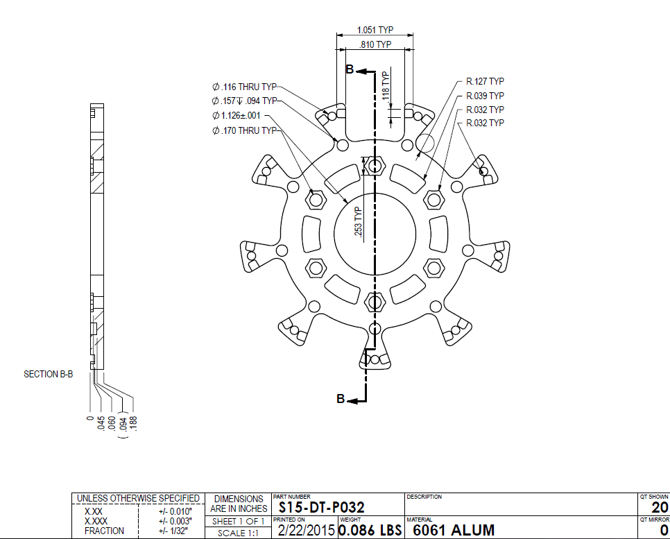

We experienced similar issues in 2015 when our rear omniwheel would hit the platform when driving on to place a stack. Here’s a drawing of a plate we made to mount to the 4’ VEXpro Omniwheels. That wheel has been revised by VEX since then, so this plate may not fit. Regardless, the concept should provide ideas for reinforcing any brand of COTS omniwheel.

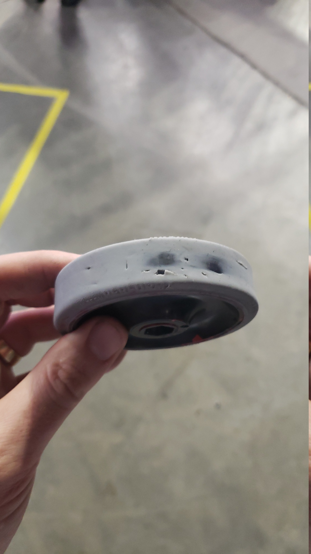

We ran 4" Vexpro omnis on the front end of the robot at the Utah Regional this week without incident. We changed them going into finals out of caution, but our rear colsons and center nitrile aluminum wheels needed change much worse (see picture).
