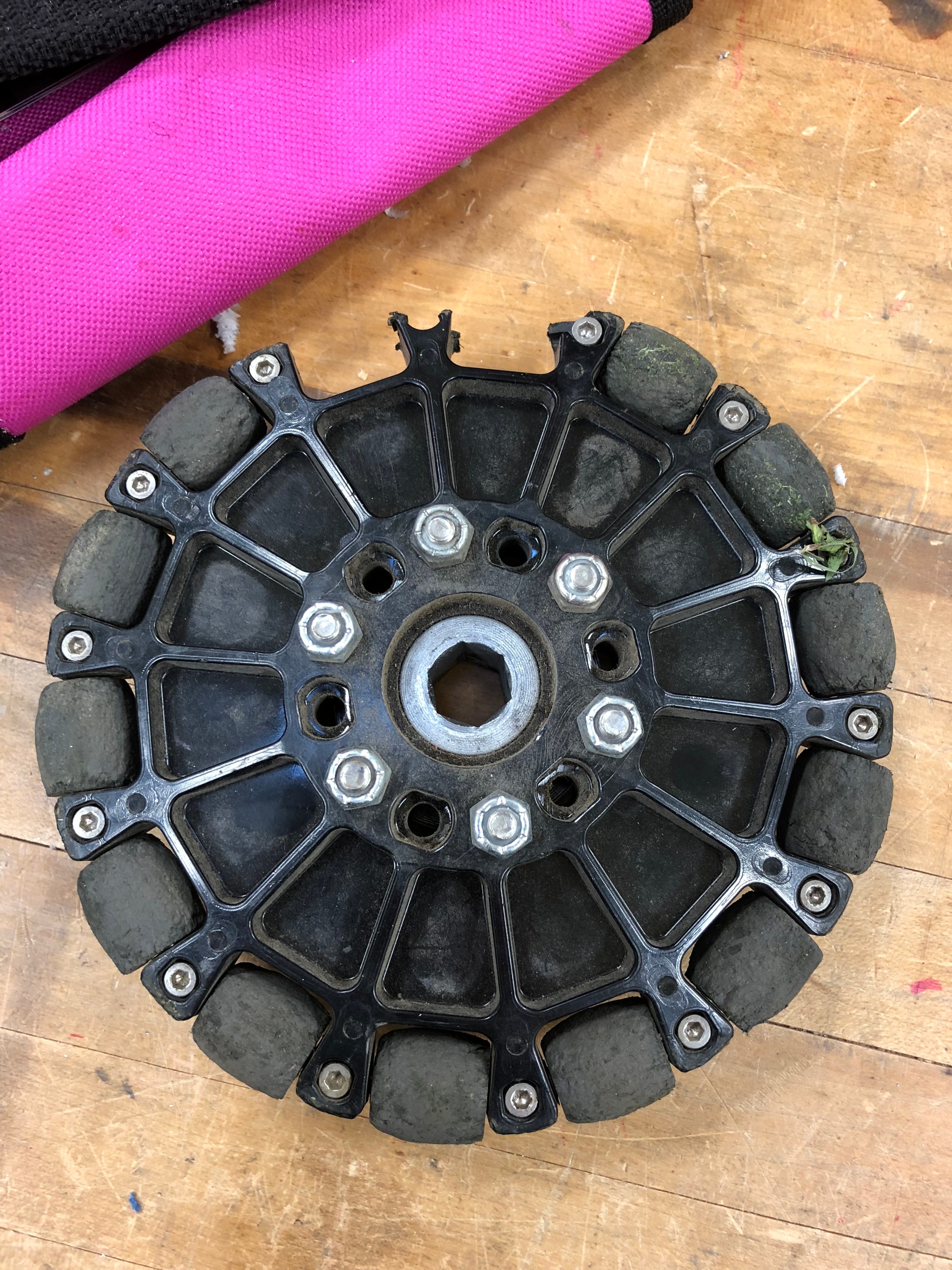

There’s nothing wrong with having omni wheels along with pneumatic wheels if you find it necessary. But keep in mind the purpose of what you’re building. For example, pneumatic wheels would make for a great out doors demo bot, as it could drive on pretty much any terrain. But omni wheels will likely break if driven off-road for extended periods! Photo below is after an 8 hour, off-road demo at a local fair…
Thank you for the pictures. Omni use is intended for carpeted/indoor hard flooring and not outdoor. Using in the school gym during pep fest and activities/events.
