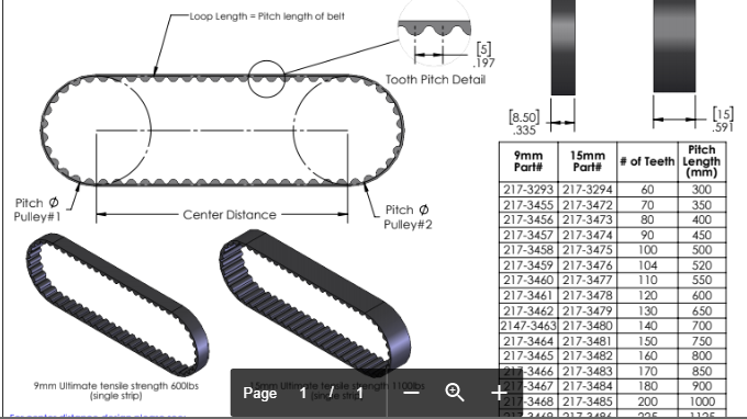

To save any one else a few minutes finding belts on https://www.vbeltguys.com/
Vex and WCP list by tooth count while vbeltguys sell by mm.
You can use the table found on Vex or screen shot to convert tooth count to mm (last column on right). Or simply do tooth pitch * tooth count. So a 100t belt is 100t * 5mm = 500mm.
Then to find the belt on vbeltguys search with the following format. BeltLength(mm)-5m-BeltWidth(mm). So for our 100t belt that would be 500-5m-09 or 500-5m-15, for the 9mm or 15mm version.
