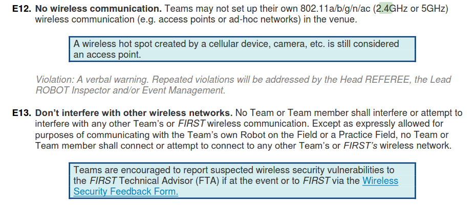

My team is currently working on creating an online scouting system for both the scouts and our strategy people to view analytics. One issue we are facing though is the problem of internet. Some competitions don’t have wifi available and some of our scouts don’t have mobile devices with data. We have considered using a mobile hotspot for all our scouts, but we all know that hotspots during a competition is not a good idea. Do you guys have any ideas on how we could get around this issue?

I thought that establishing a mobile hotspot in the arena/venue was against FIRST’s rules.
Correct

Per the 2019 event rules (and are unlikely to change), parts E12 and E13:
Given that constraint, your options are essentially Bluetooth, cellular, or some otherwise non-Wifi method of networking. Bluetooth PANs are a thing, some teams were experimenting with 900MHz radios between pit and stands. Given the sheer cost or technical expertise required for some these solutions, I suggest that you start doing sprints in the halls at your build space to practice pit running speed-walking.
