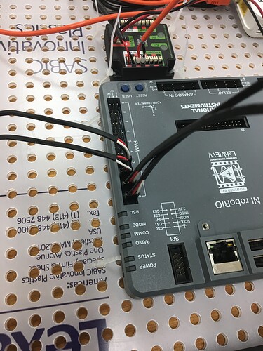

Can you post a picture of your motor controllers and where you have them plugged into. Are the small wires black/red/white or are they yellow/green?

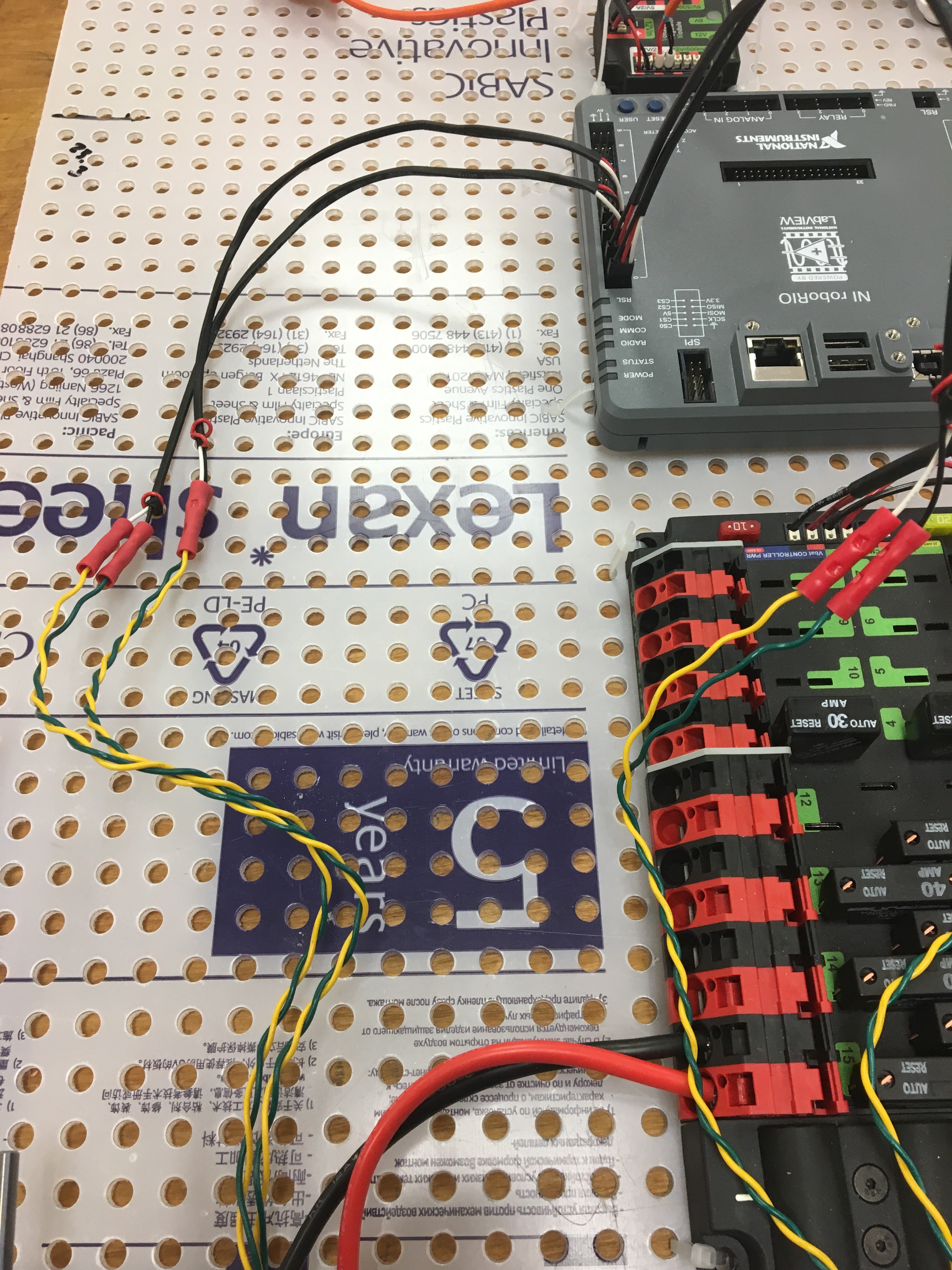

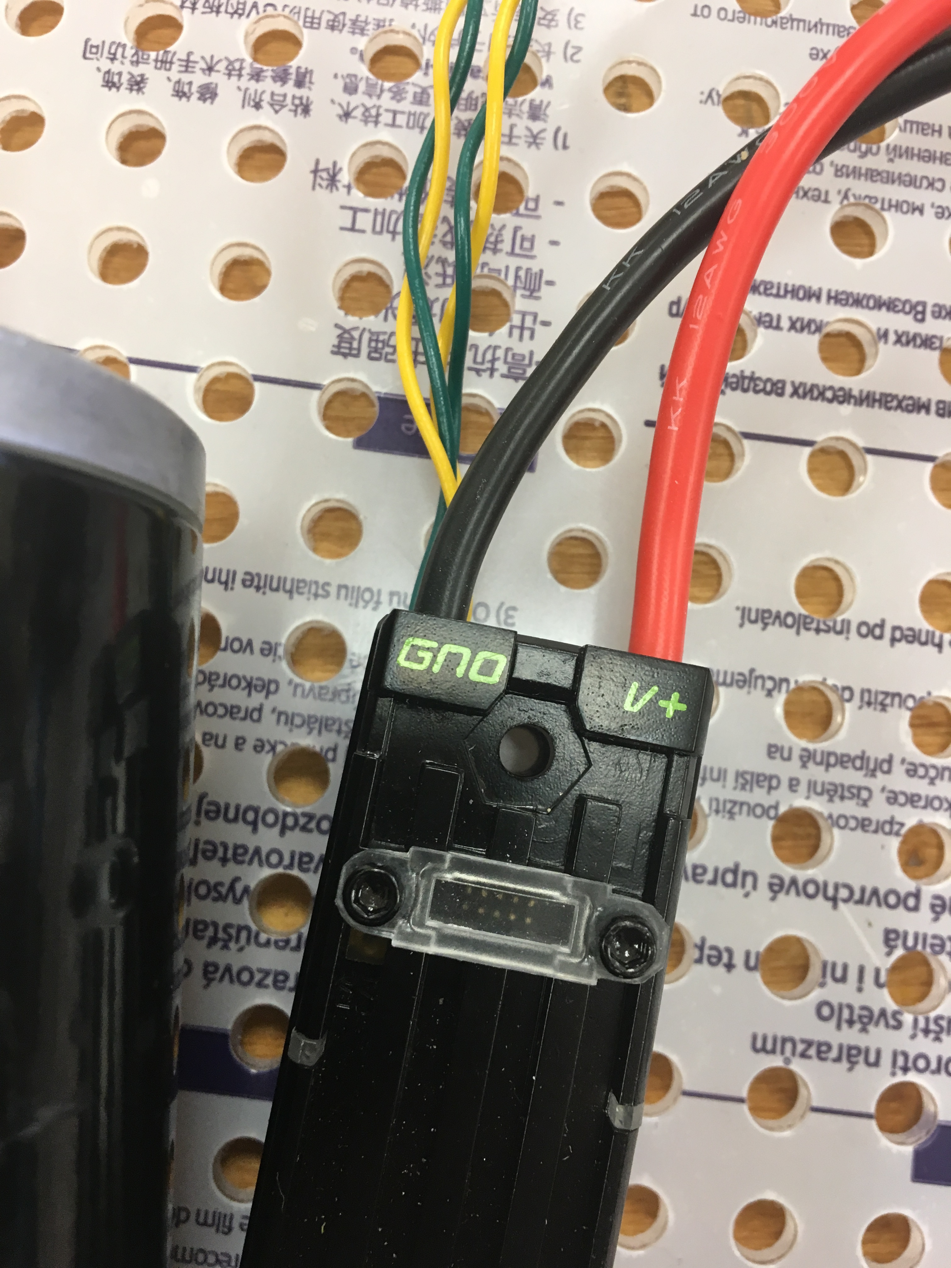

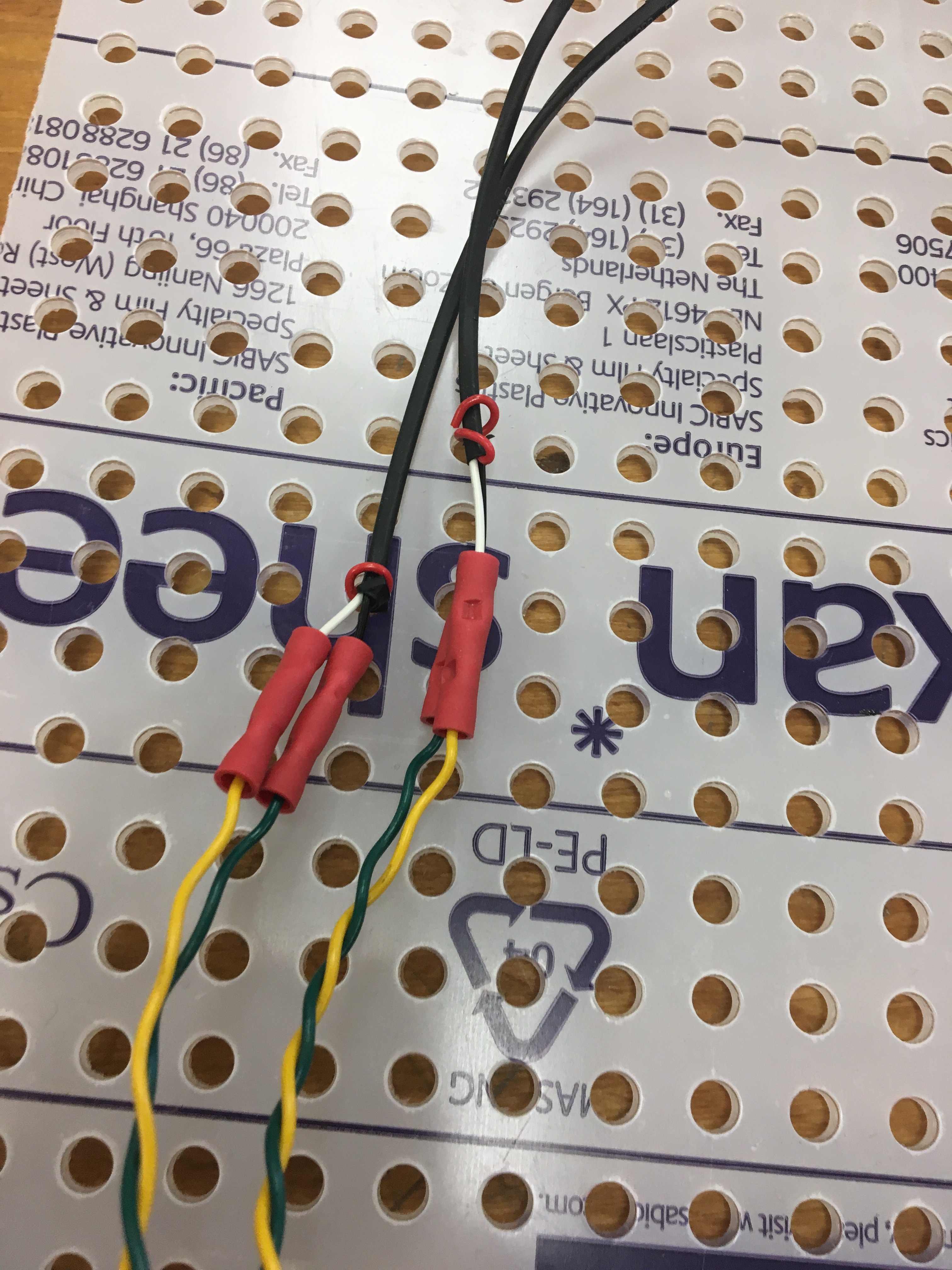

Here should be all the relevant wiring information
AH HA…
Those yellow / green wires are NOT PWM. They are CAN bus and must go in with the CAN wiring.
From there you need to install the CTR software and assign each one an ID

I don’t think we can hook up to the CAN wiring, the RIO only has two slots for CAN, which are currently being used to help connect the PDP to the RIO
You put them in-between. RIO, motor controller, motor controller, PDP. All devices talk to each other over the same lines. You can add many devices, just wire yellow to yellow, and green to green.
