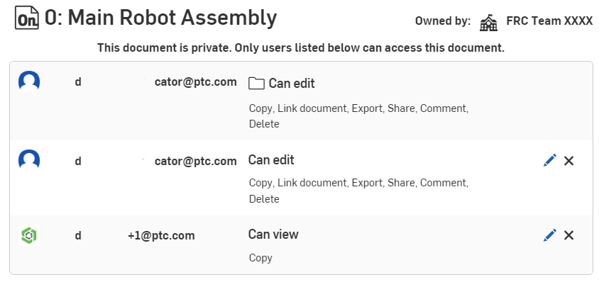

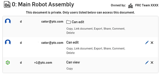

Thanks for the clarifications. Subfolders cannot have their own sharing permissions and inherit their sharing permissions for the top-level folder they are in, so a “Share” option won’t appear on those folders. When you move it to be a top-level folder, it can then have sharing permissions applied. When you move it back to being a subfolder, it will drop any share permissions it had and re-inherit the permissions of the top-level folder. Where this gets pretty confusing is that a document, regardless of what level it’s at, can have it’s own sharing permissions. This is why in the Share dialog, permissions that are given based on the folder have a folder icon, while document-based permissions have no icon:
