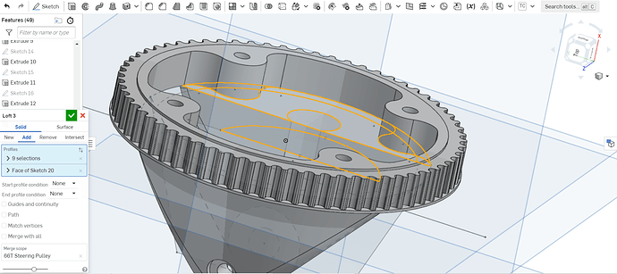

Another question/issue.
I am trying to do a lofted cut between these two highlighted profiles, but I am getting errors that it cannot create a valid part. Does anyone know what I’m doing wrong?
(Haven’t used lofts in onshape yet but in most parametric CAD…) you’re best served by making sure that the two sketch profiles are single closed loops. The upper sketch does not appear to be as such.
I’m pretty sure they are both closed loops. The top profile is just a combination of smaller closed profiles, but whole profile should be closed.
Just got it to work somehow, and I honestly don’t know how I did it. I just tried the exact same thing over and over again until it worked. Welp.
