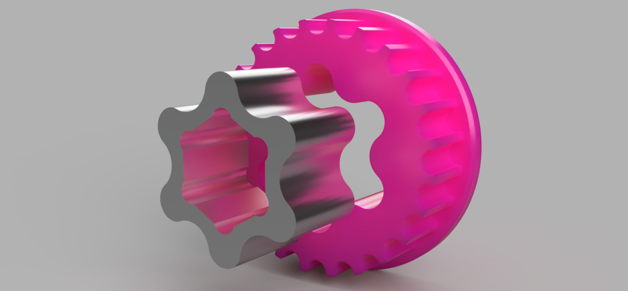

I’ve never used these, but I saw this on the Thrifty Bot update page. Seems like this might work for you:
we’ve used these and they work amazing, we where having the same issues as you and then we tried these and they solved it.
While the Thrifty Inserts definitely work, I believe the OP is in Israel. If there’s a desire for a multi-team bulk order to ship items over feel free to contact me and I can combine orders to ship together.
Some other good ideas include 3D printing your part with a geometry cutout of an existing 1/2 inch hex or 8mm keyed gear that you already have in hand and press it into your part. It will do the same thing that the Thrifty Insert does and you may already have some old gears laying around that will work for this.

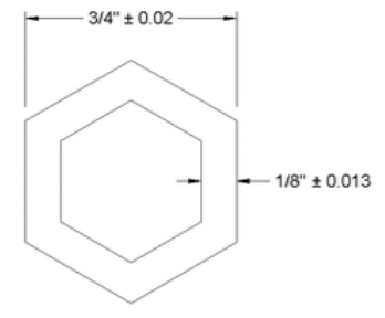

I believe some teams use the following 3/4 hex tube:
Can confirm 33 has done this with onyx printed pulleys etc over the last 3 years with success. Just chop to length and press into the pulley. You can add some epoxy if you really want to make sure it never comes out.

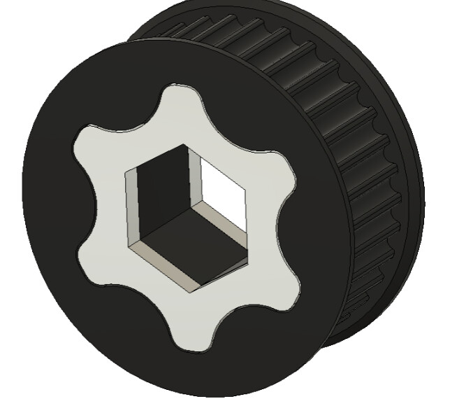

We like to 3D print a lot of our pulleys, we use this setup. Just two laser cut plates that seat into the print, works like a charm. These are effectively just the TTB product, just easy and cheap if you have a laser in house/sponsor. (Idea taken from a post by a 4414 person from a bit ago.)
Good to know this is working for 33. Do you ever have issues with loose fit to hex shafts?
McMaster-Carr data for this tube indicates generous tolerance on the inside dimension:
image image
What material are you making these with?
6061 Aluminum, the ones pictured are just 0.09"
I never personally never noticed any issue with this.
If there is excessive backlash, you can buy shim stock from McMaster also to tighten it up. This is my go-to solution after Aren enlightened me in 2016…more teams should be using it on rotational mechanisms.
