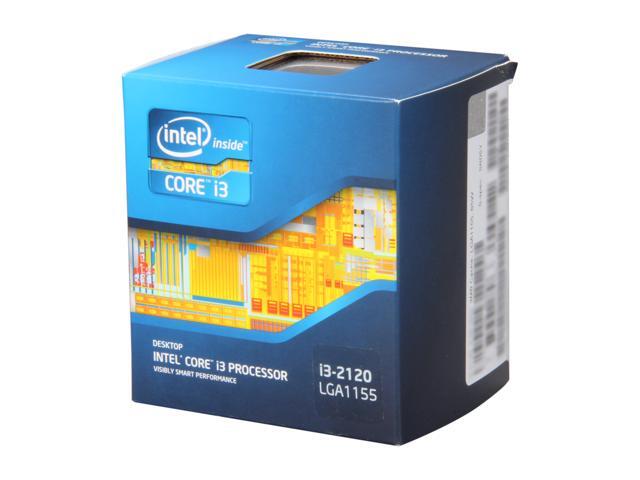

The frame rate of the PS3 eye cam is running at a consistent 120fps. We are using it to do live tracking of the backboards due to its high frame rate and its cheap price. We have a core i3 computer on our robot running linux(ubuntu) for the ease of compiling OpenCv and being able to create sockets between the computer and the cRio. (sockets are opened in python)

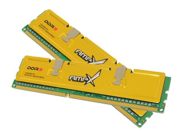

We are not using a laptop… we built our own computer. No screen or anything. we are running linux. but we are using a ECS H61H2-M2 motherboard with 4gigs of ram. we are using a 20gig solid state drive and a Huhler water cooling system. Our whole setup ran us $370~. We got two of these setups, one for our production bot and one for our practice bot. A little pricy but will carry though out the years from bot to bot for vision processing or even make a decent CAD machine if vision isn’t as necessary in years to come.

I’m the mentor for 3574 that helped put that together. My understanding of the rules is that you could. However, we kept it safe this year. A top of the line i7 can draw 130 watts of power. That translates into more heat, more battery drain, bigger motherboard, and a larger power supply.
The i3 we went draws just 65w and uses a MicroATX mother board, but at 3.3ghz processes the 640x480 60fps feed from the PS3 eye cam in real time.

For those interested, here is the buy list for the vision processor:
http://www.mini-box.com/PW-200M-DC-DC-power-supply
http://www.mini-box.com/P4-ATX
