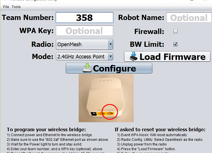

I have an OpenMesh radio that was working yesterday. We switched computers, tried downloading the code, but no luck. Went through the configuration program for the radio, but we cannot get the radio to show an IP address when powered on and connected to the computer.
I think the problem is a result of firmware upload failing. I looked on Open Mesh’s website, but I can’t figure out where to download the firmware to flash the radio. Any ideas?

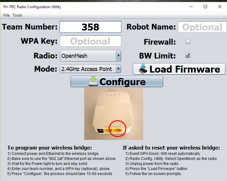

Use the same FRC Radio Configuration Utility 17.3 (2/14/17)
to reflash the OpenMesh firmware.
Use the **Load Firmware **button.
