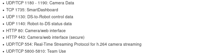

In 2019, to accommodate the inevitable USB camera on every single robot, FIRST cut the bandwidth from 7Mbits/sec/team to 4Mbits/sec/team - nearly in half! And just as our team of elite fortune-tellers predicted, that cut remains in full force for the 2020 season at least. So we searched for a solution. And the manual delivered.

The first thing rusty-engine does is make your drivers very, very happy. H.264 can encode nearly twice the resolution as the roboRIO CameraServer in the same or even less bandwidth. It accomplishes this by encoding most of the frames in the video streams as (essentially) transformations of the previous frame, while only sending complete images when absolutely necessary or on a reasonably low interval. (In contrast, every single frame from a roboRIO CameraServer stream is a complete JPEG image.) Because of this, you can have a drastically better-quality stream for your drivers without breaking the FMS.
All you need to do enable H.264 on your OpenSight installation is change the “backend” setting of a CameraServer node from “MJPEG” to “H.264”:
