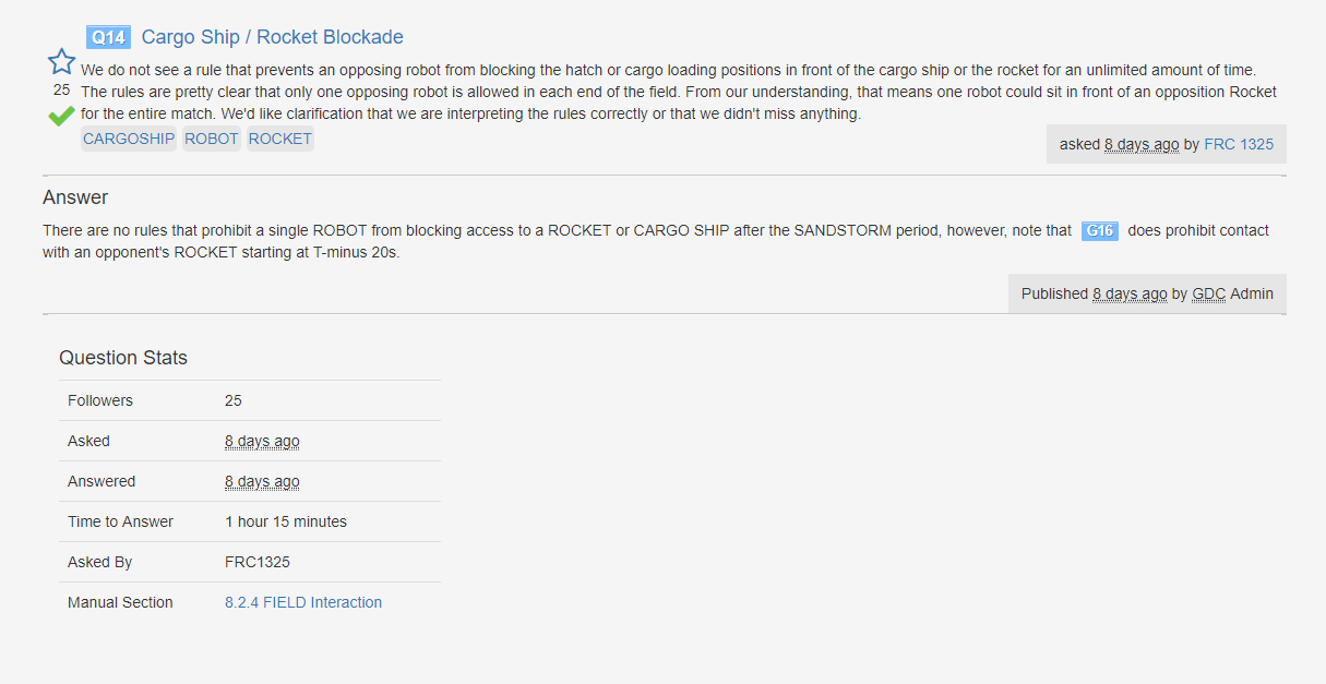

Opinions on Rocket blocking defense based on Q&A 14?
In Q&A 14 ( FIRST FRC Q&A System ) it states there is nothing preventing a robot from blocking either the Rocket or the Cargo Ship form the entire match (except the las 20 seconds) this strategy seem viable but only to prevent the other alliance from getting a ranking point not from winning the match.
What is your opinion on this strategy from both sides being applied to you or applying it.
