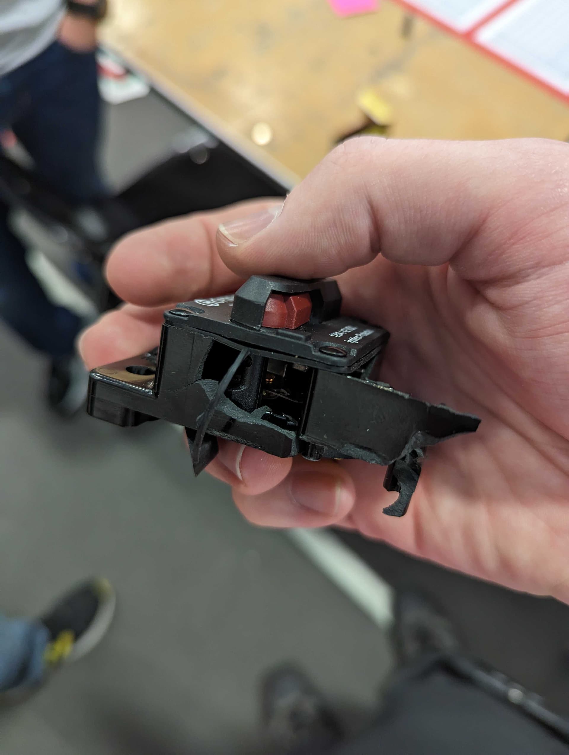

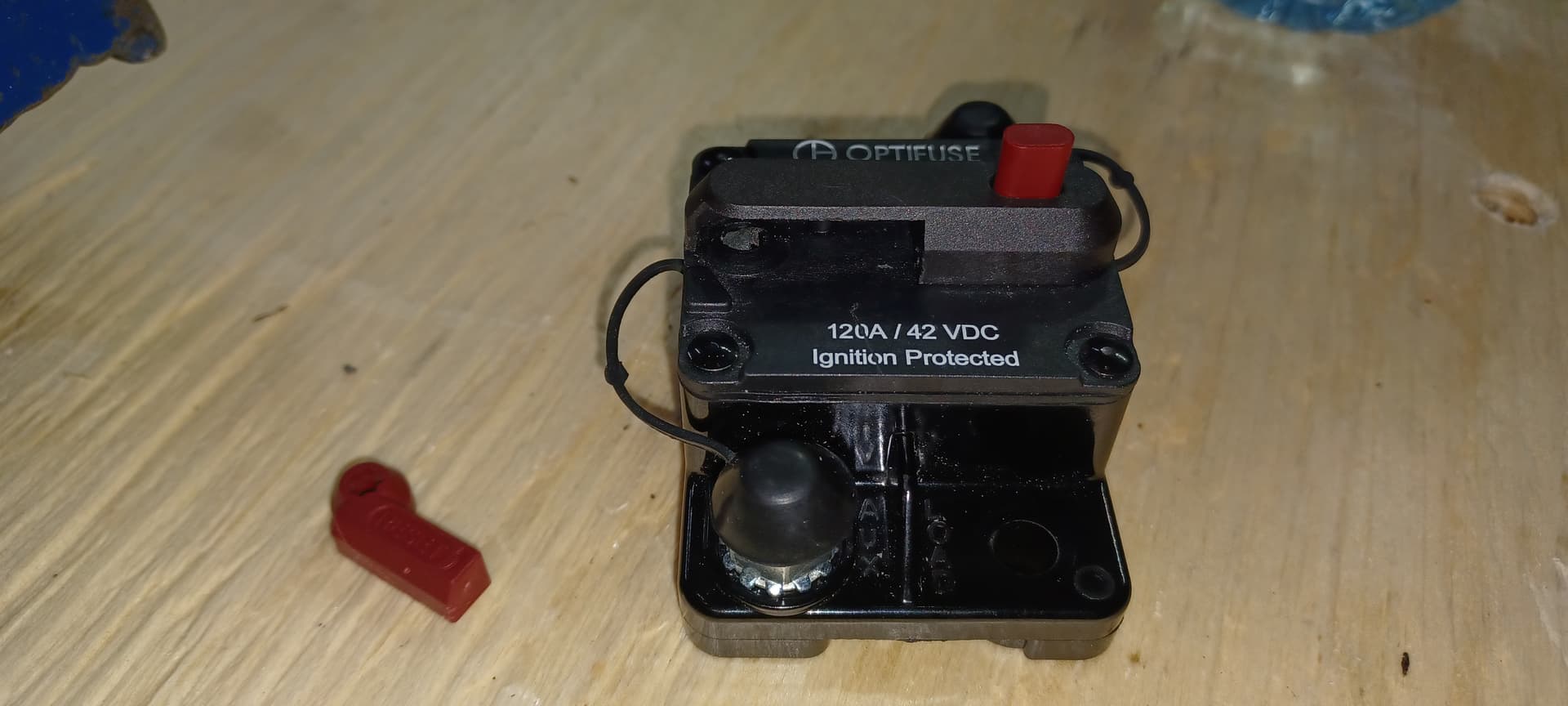

At the Las Vegas regional, our robot’s main breaker failed as we were setting up for a quals match, causing us to be bypassed for the match.

At the North Carolina DCMP I was inspecting, and followed an experienced CSA into the pit of a robot that had been playing well then mysteriously powered down mid-match. Might have been 4561?
The CSA noticed that the breaker was by Optifuse, then I think ohmed it out. He immediately got the team a Bussman main breaker from Spare Parts. The removed Optifuse braker had a suspicious rattling sound when shaken.

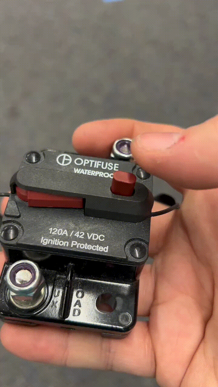

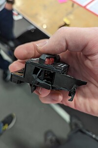

Here’s a non-exhaustive list of failure modes for the Optifuse breakers that aren’t frequently reported with Bussman breakers:
  • Attaching them to something with bolts shatters the black housing (without any excessive forces)
    • I’ve personally broken two by simply attaching them to a robot, and I know of at least one other team that has had this failure.
  • The housing can crack from non-direct impacts (like bumper-to-bumper contact)
  • The internal mechanism for the red “off” button can break, causing the breaker to “fail closed” (fail while turned on and become impossible to turn off), which is exceptionally dangerous
    • IMG_2602
  • As seen in OP’s image, the red “on” lever can break off, rendering them inoperable
    • This one is new to me, and seems to be related to the brittleness of the black plastic
  • The breaker can “fail open” where the “on” lever won’t stay engaged and the breaker won’t supply power
It’s a shame that these were included in the KOP this year, and in FC last year. Several people have been ringing the alarm bell on Optifuse breakers, so I hope FIRST finally gets the message that they need to be banned.
If you have Optifuse breakers, get rid of them. Don’t relegate them to a testbed, because someone is bound to rip it off and put it on the robot when they can’t find a Bussman one, or end up accidentally donating them to an unsuspecting rookie team.
