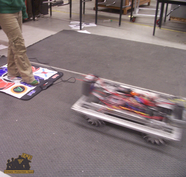

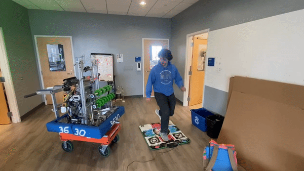

made a new controller like this “public static GenericHID ddrPad = new GenerixHID(1);” then used POV controls to control the climber’s motor and solenoids like this:
if (Robot.ddrPad.getPOV() == 0 ){
climberTalon.set(ControlMode.PercentOutput, 1);
else if (Robot.ddrPad.getPOV() == 180){
climberTalon.set(ControlMode.PercentOutput, -1);
if (Robot.ddrPad.getPOV() == 90 ){
openSolenoid();
} else if (Robot.ddrPad.getPOV() == 270 ){
closeSolenoid();
