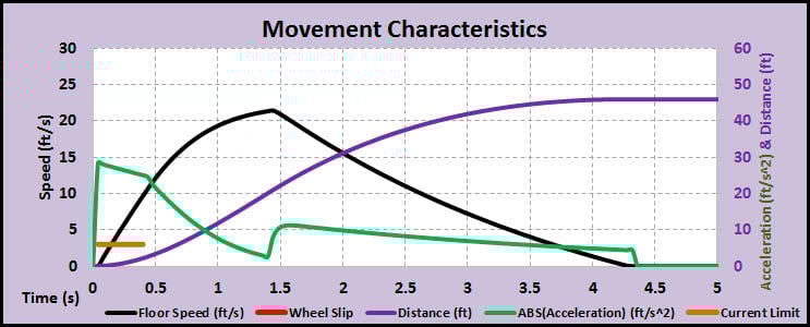

So, there I was, out doing yardwork, thinking about differential swerve, when it occurred to me that the main reason to build a differential swerve is to have 8 motors applying power to the wheels. But a drivetrain with 8 CIM-class BLDC motors would most likely be highly traction limited if it was geared to the same gear ratio as a typical 4 motor drivetrain.
So, after the yardwork was done, I plugged some numbers into the ILITE drivetrain simulator. For a 4 NEO drivetrain, assuming 4 inch wheels and 150 lbs full-up robot weight and a 20 foot sprint distance, the optimal gear ratio for sprint time is about 5.5:1 or so. This ratio results in a theoretical free speed on 20 ft/s. I realize that this is on the high side, and there are some other factors that come into play when you select a gear ratio, but let’s use this one criteria (minimum sprint time over a 20 ft sprint) as a comparison point.
The first thing I did was just change the number of motors to 8, leaving all other factors the same. The time to 20 ft was improved to 1.4 seconds, but sure enough, the first 8 ft of the sprint was slip limited. Reducing the overall gear ratio to 4:1 improves the sprint time to 1 second and is no longer slip limited. This results in a theoretical free speed of 25 ft/sec. I think most of us who have been around for a few years would consider that speed a bit too close to plaid for comfort (i.e. ludicrous).

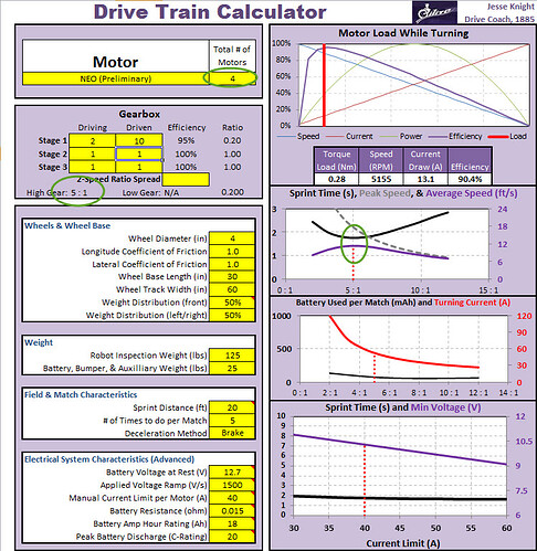

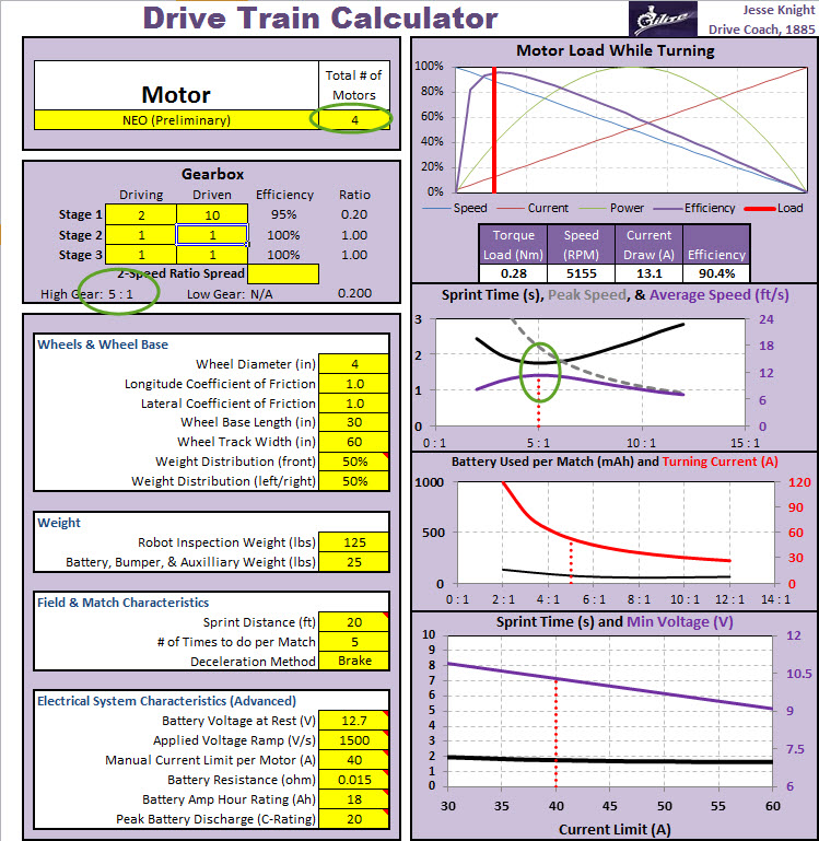

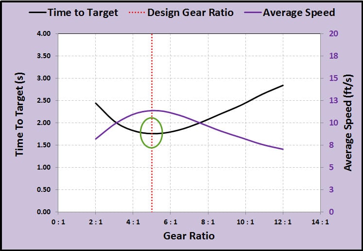

Here is the calculations for a 4 NEO drivetrain showing the optimal gear ratio of somewhere between around 5:1 and the sprint time of 1.7 seconds:
Note: I realized as I was re-running these calculations that the ILITE simulator only accepts integers for the driving and driven gear inputs. I had tried to simplify my earlier test by just putting in decimal values for the gear ratio, but it just rounded it off. So my earlier statement about 5.5:1 was not correct. The ILITE simulator was actually using 5:1 for that calculation.

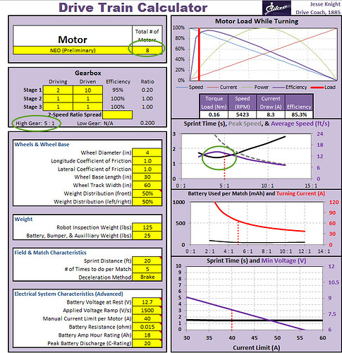

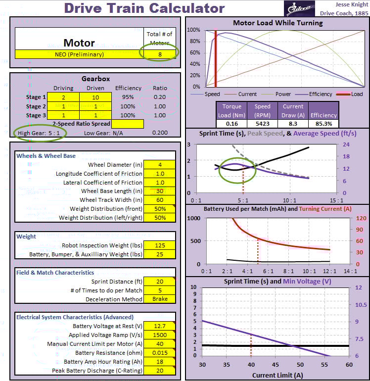

Here is the calculations I ran with the 8 motor drivetrain. First with the same 5:1 geartrain showing the wheel slip and the 1.5 second 20 foot sprint time and the wheel slip limit for the first 8 feet:

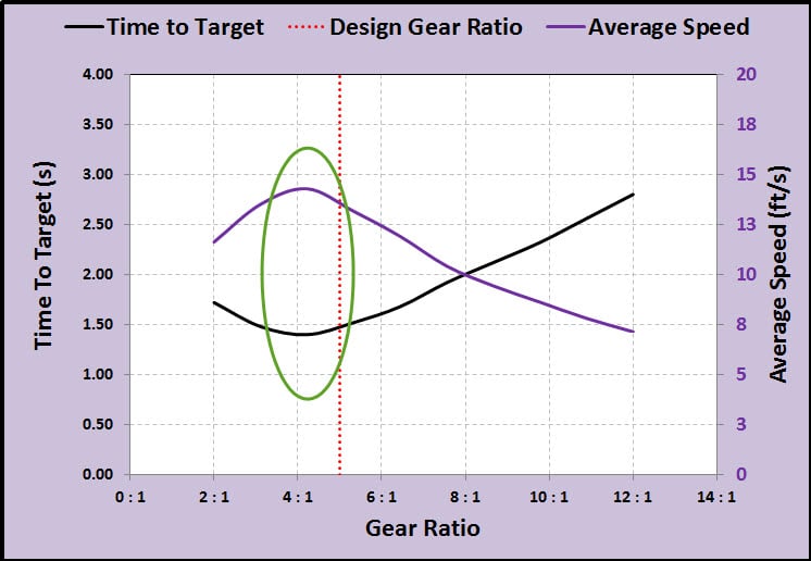

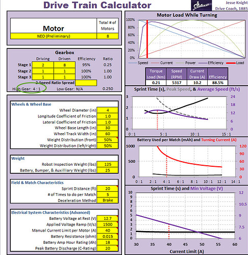

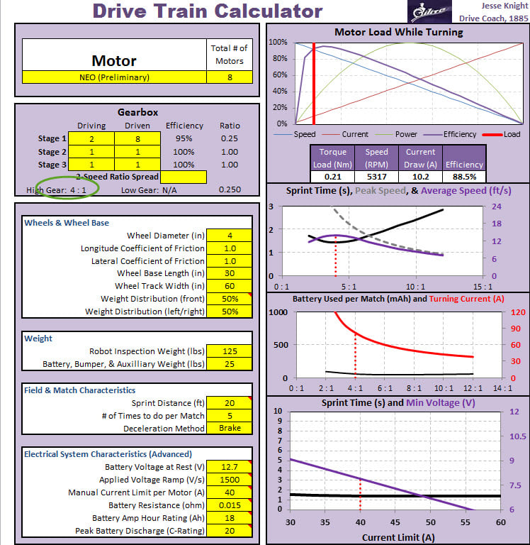

And then with the 4:1 ratio which reduces the 20 foot sprint distance time to 1.4 seconds and no longer hits the wheel slip limit:

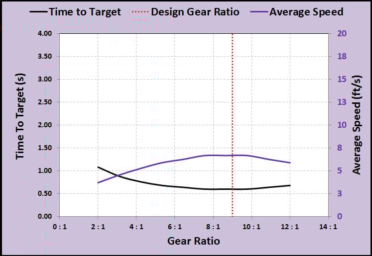

As an aside, I looked at shorter sprint distances for the 4 NEO drivetrain with 4" wheels. Based on those studies, the ILITE simulator suggests that the optimal gear ratio is:
  • 6:1 for a 14 foot sprint
  • 7:1 for a 9 foot sprint
  • 8:1 for a 7 foot sprint
  • 9:1 for a 4 foot sprint

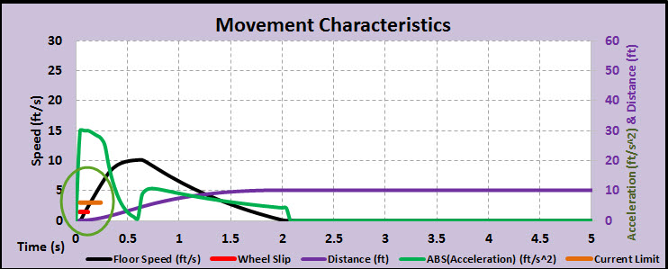

Here is the plot for a 4 foot sprint:

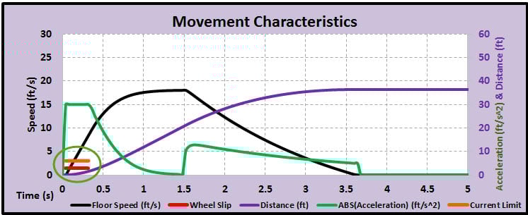

Also, the ILITE definition of ‘sprint distance’ is the acceleration distance (i.e. the distance to get to the max speed before you start decelerating). The full 0-Max-0 distance is longer than that. That may not have been clear in my initial post.
Edit: Something else that happens with the 9:1 ratio example is that you start to see wheel slip in the early acceleration (you are slip limited at stall):
So the 9:1 gear ratio sprint time for the 4 ft sprint is the same as the 8:1 gear ratio sprint time according to the calculator (0.6s). In real life the 9:1 might be worse if you let the wheels actually slip because the friction coeffiecient when slipping is lower than when not slipping such that you can’t get as much acceleration. and the 9:1 ratio results in a lower free speed, yadda, yadda, yadda. So, when you become slip limited you have hit a performance wall that you cannot push through and adding more torque is with a higher gear ratio is no longer helping the short sprints and is actually hurting you in the longer sprints due to the lower free speed. Thus, it is always a balancing act between short sprints and long runs and each game and each game strategy presents a different optimal point.

I guess whenever I look at optimal gear ratios, I look at a time to distance overall, I’m not sure what good looking at the “sprint distance” of the acceleration distance does for me. If my cycle distance is 20ft, I want to optimize how long it takes to travel that entire distance from standstill.
I do not have data in a publishable state at this time; this was internal testing we have done as a team over the last couple years.
Typically I understand that spring distance includes acceleration distance, unless you mean slowing down and coming to a stop as well. I’d be interested in seeing your data once it’s ready to compare, but until then 20fps sounds about right for maximal speed medium sprints (although as we know, these are typically rare).
