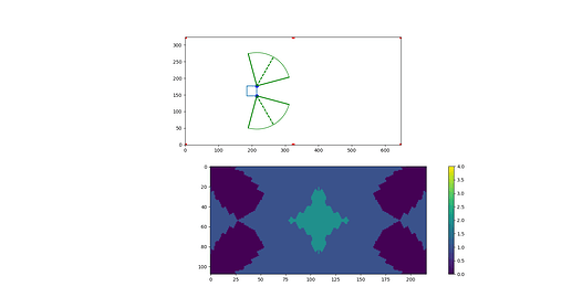

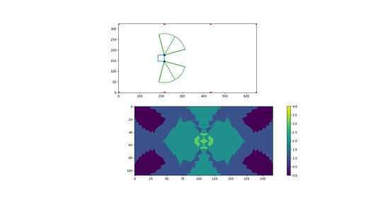

I wrote some quick-and-dirty Python code to examine how “visibility” (ability to see at least one tag) is affected by tag placement on the field, and camera setup on the robot. I define some tag locations, and some cameras (FoV, location, orientation) and then iterate in X and Y across the standard field size. At each location, I iterate through many possible robot orientations, and take the minimum number of tags visible. That is, the analysis I’m doing is, “at any given position on the field, what’s the minimum number of tags in view, across the possible orientations?” Then, I plot those values on a heatmap.
Caveats:
  1. I solely evaluate whether a tag is in the field of view of a camera, without regard to range.
  2. Neither obstructions on the robot nor the field are considered.
  3. This is a strictly 2D analysis.
(I’ll post code as soon as I can get back into my github account. Damn you, 2FA.)
Some results
Figure_7
Figure_8
If nothing else the math is pretty. It seems like what we would expect. Best chance of catching the most tags is with a 360 degree spread of cameras.
