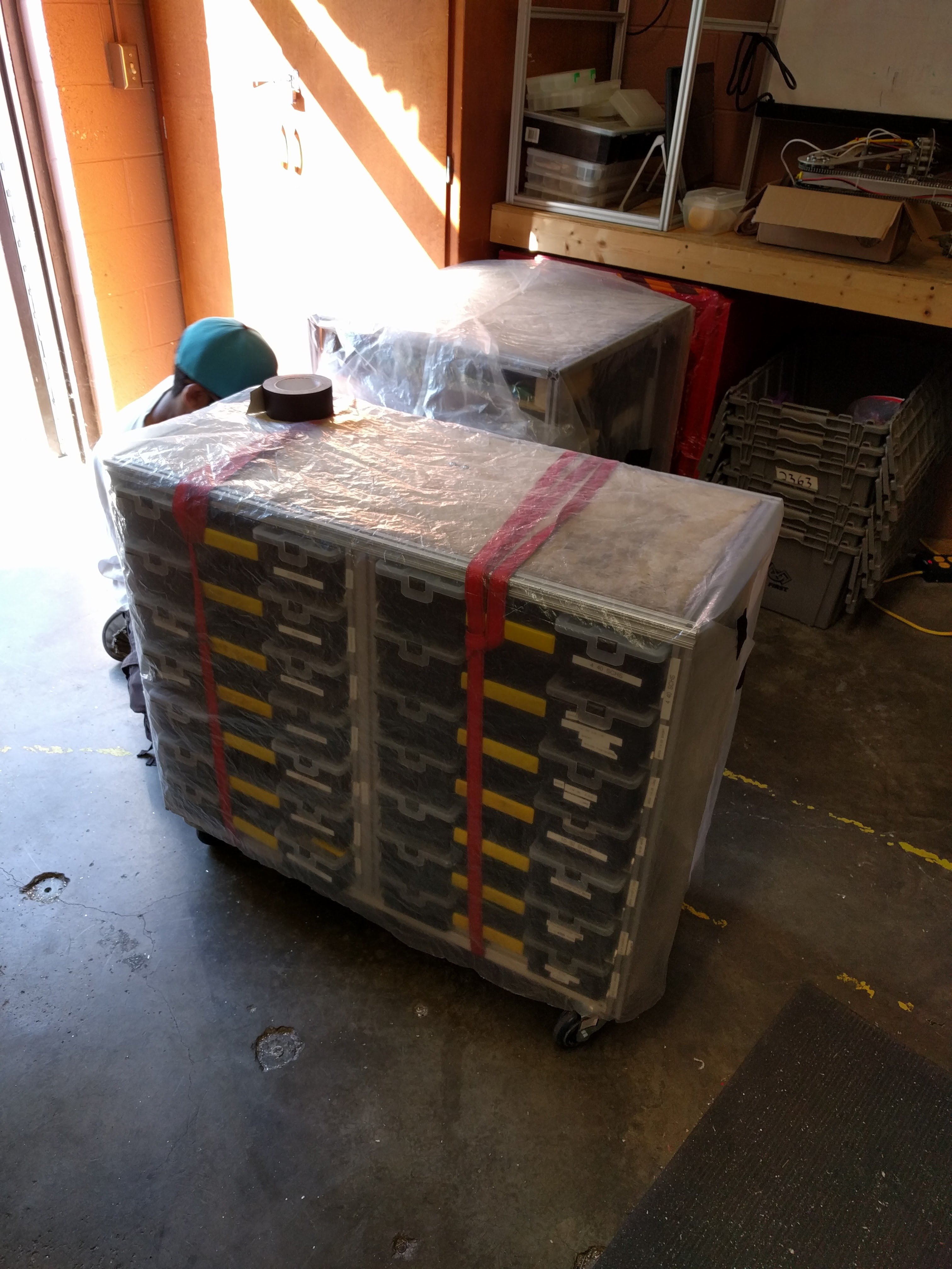

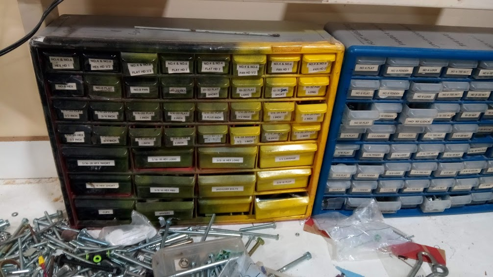

We have 2 organizers like these (I forget exact size/# compartment). One has nuts/washer while the other has bolts/screws. To take to competition, we wrap the entire thing with stretch wrap. They are all painted with a spray paint gradient (before affixing labels) from top left to bottom right, which helps when you take a compartment out and want to put it back. We fill up boxes before season, as needed, and before competition. But we buy in larger quantity boxes and keep those in another box for refilling.

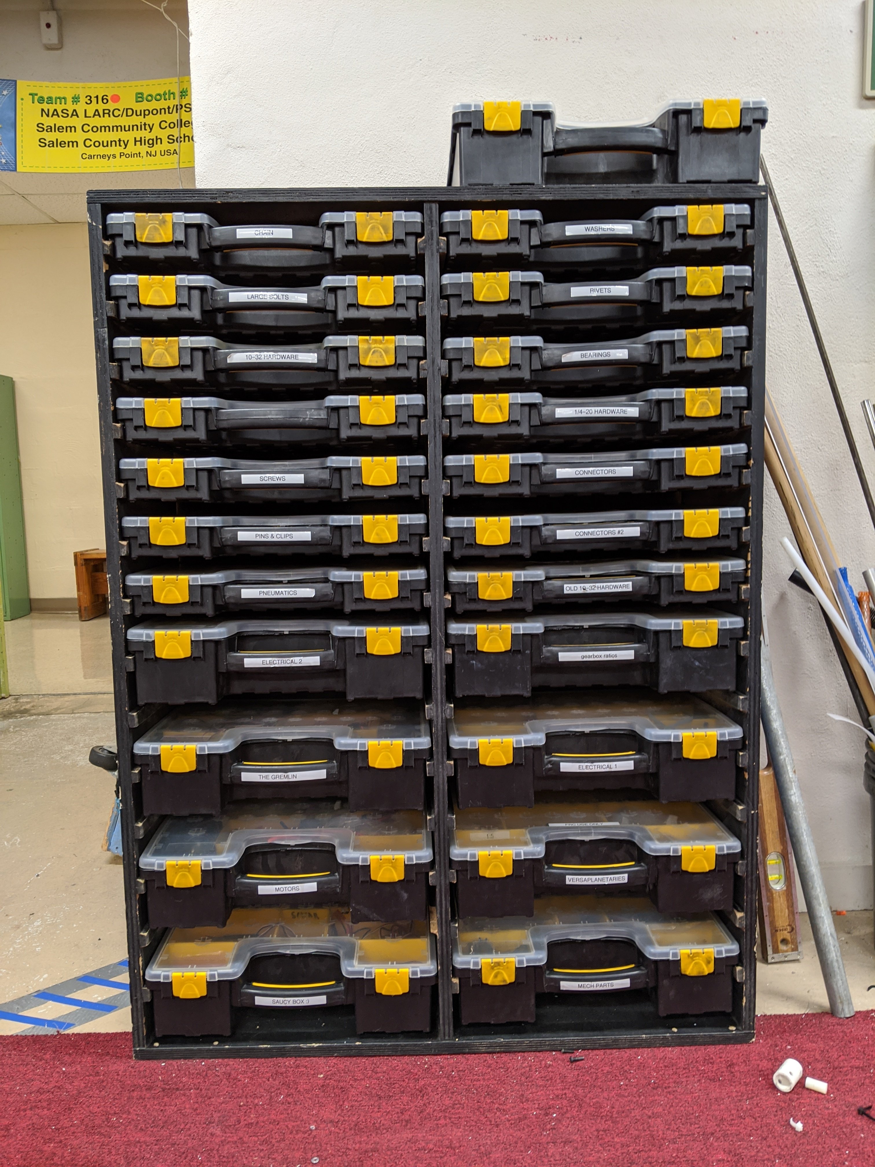

On our pit setup (i dont have a picture right now) we simply have 2x2 wood strips on either side of an opening. They are set up in such a way that the edges of these containers sit on them nicely, while not “stacking”. The containers are thin enough that you can fit 6-8 on a slightly-higher-than-waist-high pit (not sure of the actual height)

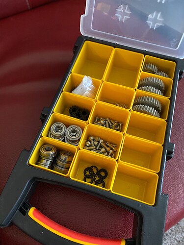

3946 does the same, but with the yellow and black boxes with the removable bins (Portable Parts Storage Cases), some from HF, some from other places. They travel easily.

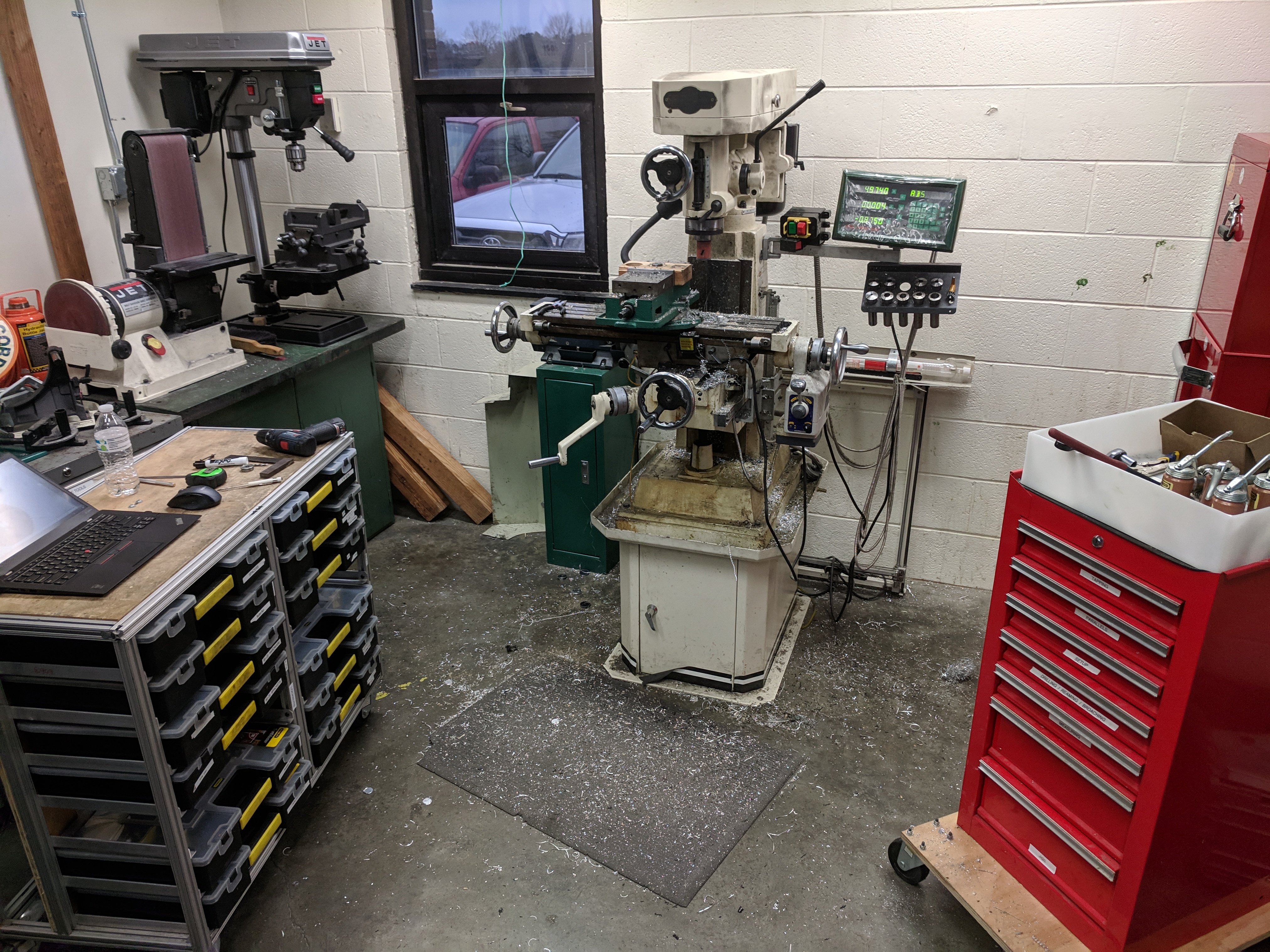

At my work, we do it with a mix of the Stanleys and a small rolling toolbox that has each size in its own drawer (with a few exceptions–I think it’s the #8’s, #6’s, and another tiny size sharing a drawer).

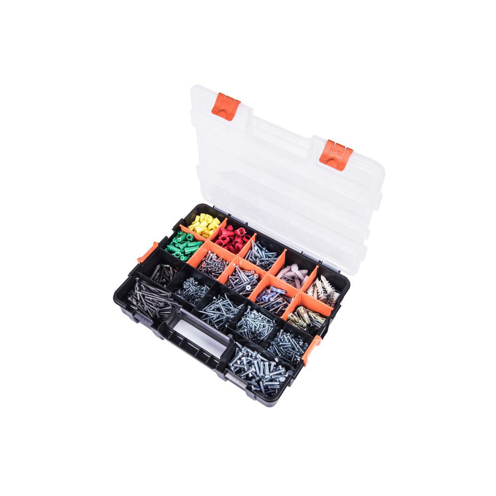

My team used something like this. We had i think 6 total. They were very nice to seperate nuts, bolts, electronics and pneumatics.
https://images.homedepot-static.com/productImages/f3ed83ee-73bd-4c54-a304-dbcc3170d9b3/svn/black-and-orange-hdx-small-parts-organizers-320034-e1_1000.jpg
For personal projects I’ve been using the Harbor Freight small storage organizers. I don’t have a picture of them more full but I’ve been trying to do them by system so that everything you need to assemble or repair is in one box. The big downside it likely results in duplication of parts (if I use a lot of 34T gears maybe the drivetrain runs out but the intake system has spares, may not know that) There’s tradeoffs to that, but the big advantage is that instead of having 5 bins needed for work I can just grab one.
