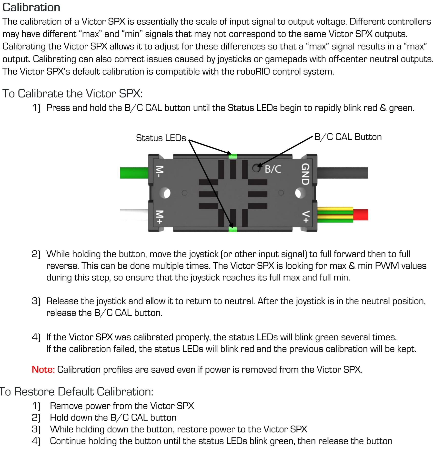

That could also be a miscalibrated motor controller. The calibration restore at the bottom of this graphic is what you’re probably looking for.
