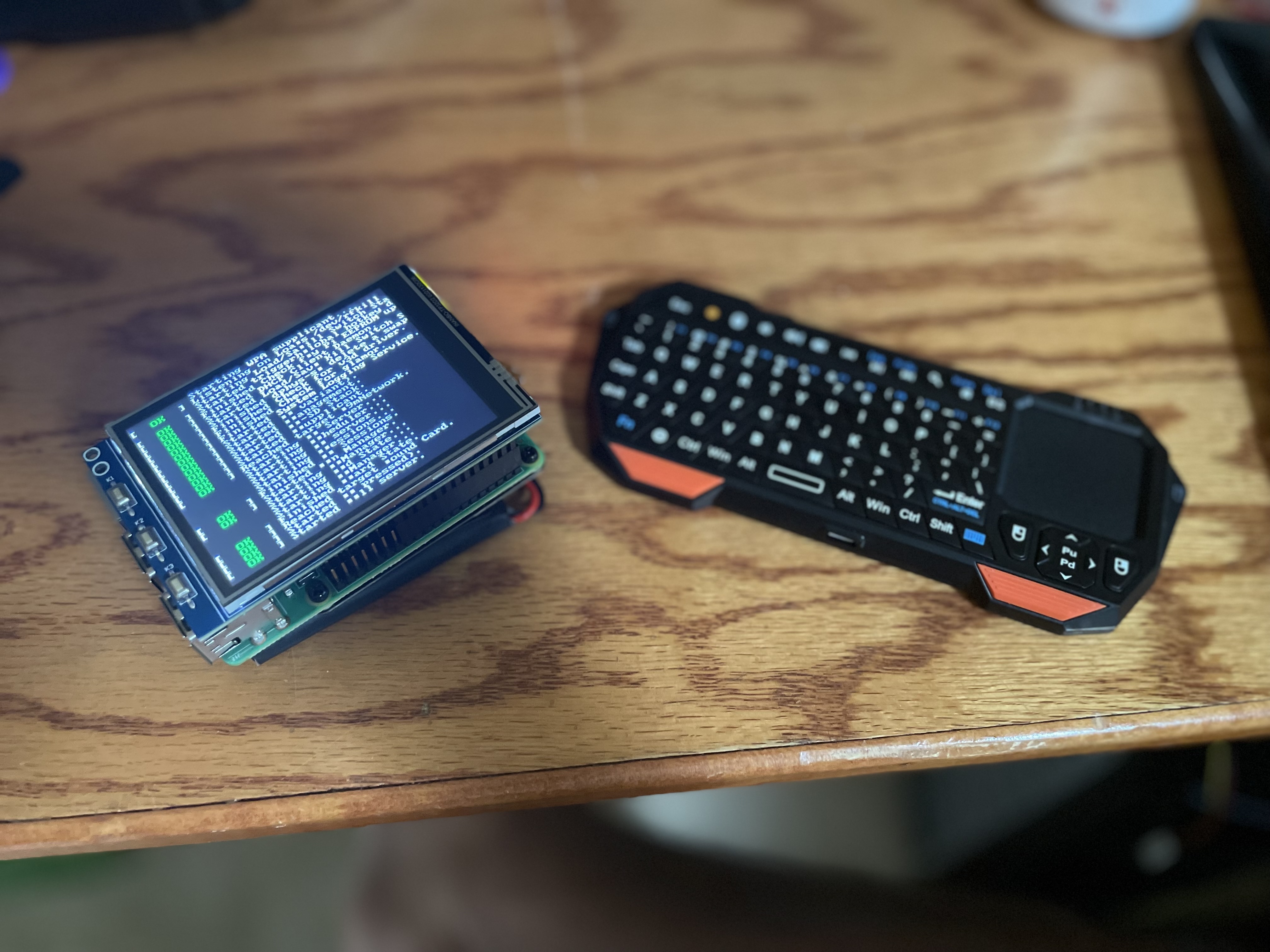

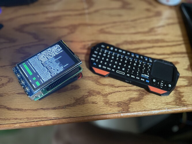

For a long time ive been working on another scouting system. In a world full of them, im not trying to compete, im just showing what I think is the best solution for my team. I’m part of team 5199 Robot Dolphins, and we have, like many others, have been working on a scouting program of our very own. I have been one of the sole workers on the programming side of this project as i professionally specialize in data visualization, and took it upon myself to mix my two favorite hobbies.
Currently, the inplimentation we are using is a web-based form which users can input data through a GUI, it saves that data locally on the device and sent through Bluetooth to a central database. That central database hosts the entire webserver, database, and also has enough processing power to run the in-house data visualization program I am developing with the d3.js library. All these fancy words to say, we are creating a new solution which takes a lot of difficult to solve problems, and solves most if not all of them. Including JSON page configuration for easy form changing between or during seasons. Multiple storage locations for minimal data loss while still having immediate analysis results. And disconnection to the interwebs to make sure everything runs in the worst possible conditions.
Currently the software is under development, and is really only half functioning. But the hardware has been prototyped and tested as a viable solution. It is centerd on a raspberry pi which has its own redundant power supply that can last on its own ~6 hours. A screen, mouse, and keyboard for 100% remote operation. It hosts the webserver using a Bluetooth PAN network and can be wired to any display for immediate visual analysis of the data it holds within.

I have seen many discussions on this topic and looked into a lot of them as I was developing my solution. On ChiefDelphi, the consensus seems to be Wifi bad, Bluetooth maybe kind of ok. And that’s the way I’m doing it. I don’t know how to make a proper app, so I wanted to stay the way of a web service. And since WiFi was out, and cellular is always spotty, I used Bluetooth. The Raspberri Pi creates something called a Bluetooth Pan network that devices connect to. Its run entirely on bluetooth, however the devices on that network think its a normal wifi network. So all i had to do was create an apache webserver on the Pi, make sure it ran through the bluetooth network, connect devices to that network. And you can access the hosted website through a normal web browser

I doubt it would be far enough. Ive tested it once and it went about 15-20 ft in the stands before the signal degraded too much. Our strategy team usually comes to the stands during team picking so it isn’t much of a problem for us. However i am working on a solution where you would walk to the stands, reload the page, and could walk away after storing all the relivant data locally. If you have a cellular modem that could also work by hosting the website through that.
