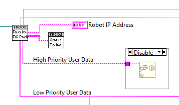

From what I can see, you have dropped a network variable on the dashboard. That is not the protocol used to send data from DS to Dashboard, but is an industrial and rather heavy-weight protocol for distributed measurements.
In the attachment, there is low and high priority user data. Whichever you are attaching to on the robot is the one to decode on the dashboard. You can also probe the string to see the packed data before you make a guess. Enable and unpack the data and then use that rectangle data to update your rectangles.
Greg McKaskle
Thanks for your responses guys, I made the changes to the data format, but I’m a little confused about what Greg McKaskle said. Greg, could you explain a little more? The thumbnail you attached looks the same as what I already have in the code. The High Priority User Data gets fed into a variable and then unflattened up in the camera loop.
My attachment showed the disabled code for unflattening the high priority data, and the wire with the low priority too. If you are using the high priority data, check to see what is in the string and check the type you are unflattening it with. You may even find it useful to go back to a simpler type in the C++ and LV dashboard, and get that working, then add elements a few at a time to learn which is failing.
