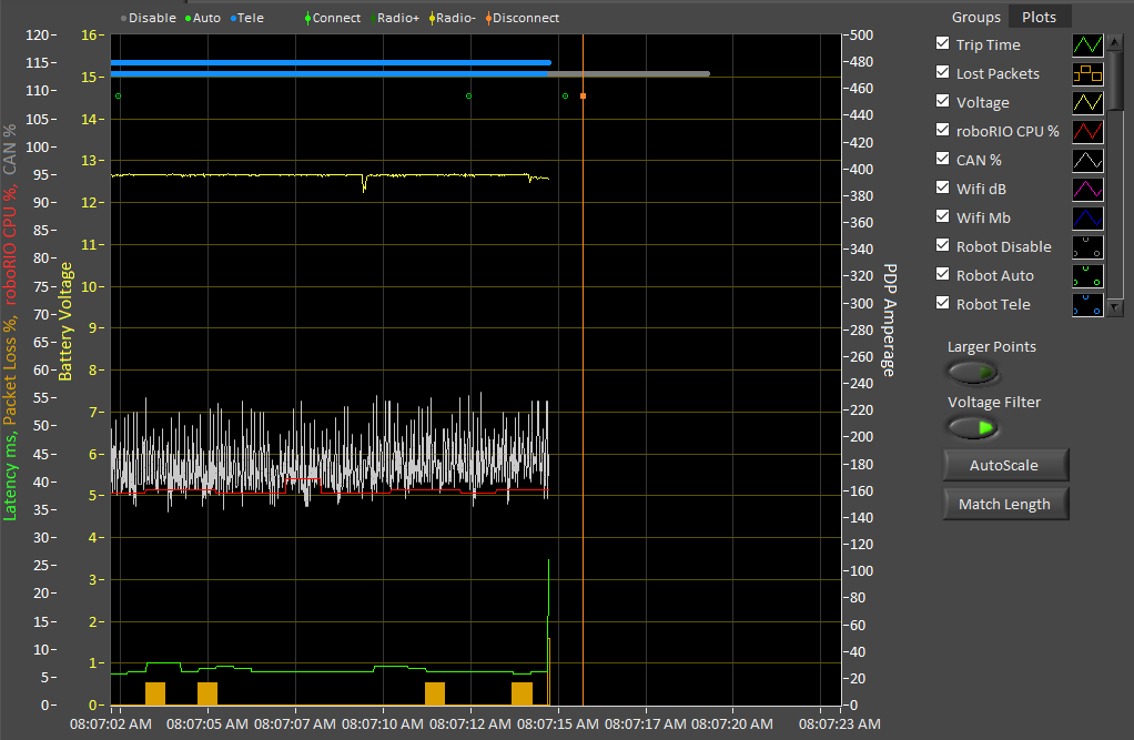

I recently made a post for what I thought was an issue with a wifi adapter on our drive station computer.
There is massive packet spike when either the wifi menu is open or the drive station window is moved somewhere else on the screen. Simply clicking and dragging… bam, packet loss is near 100% for a solid 2-3 seconds! Pictures attached illustrate the issue in simple terms.

We also experience these losses at random times in addition to the triggers seen above. Occasionally the robot completely disconnects for a split second. We have no idea the cause and are desperate for a solution.
Thanks in advance for any help!
Edit: Logs from a disconnection that happened randomly.

Turns out it happened quicker than I thought. Linked are two logs, it spawned a new log on disconnection. I do not see anything of interest, but I am not knowledgeable in this respect.
So, things look pretty normal (I assume the robot was just sitting there?) and there is a loss of communications which lasts ~8 seconds. This is consistent with something going on with the WiFi on the DS computer. Is this something that happens periodically (say, every 5 minutes or at whatever regular interval)? Is there anything going on with the robot at the time? This is a fairly strange set of symptoms, so getting as much information and as many clues as possible should help here. If you tether via Ethernet, to the radio, does this make the problem go away?
