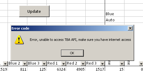

Is this something that can be fixed?
I obviously have internet access, or I wouldn’t be able to post this from the same computer :slight_smile:
That error message is of my own making to catch a known error that can occur when there is no internet connection, but in your case it is being displayed for a different error. I played around with libreoffice a few weeks ago to try to get it to work. The problem seems to relate to the json parsing module that I am using. If there exists a different json parsing module out there that works with both libreoffice and excel I would be happy to try it. Alternatively, if someone who knows libreoffice macros better than I do could hunt down exactly why I am getting this error, I could change my code accordingly.
My attempts to determine why this error occurs have left me baffled.
