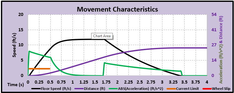

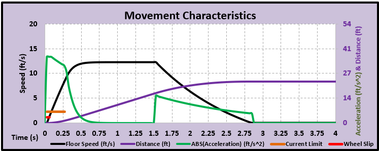

The simplest way I can explain this - if the wheels slip under max current limit, then weight is not a factor in determining current draw / current limit.
To demonstrate this, use 4 NEOs on a 140-lb (total weight) robot with a 7.5:1 ratio and a current limit of 30A per motor. I also set the CoF to 1.2 to eliminate wheel slip being the dominant factor at a lighter weight. In this scenario, the wheels do not slip, and we can see the current is limiting acceleration.
Here, the weight is changed to 70lbs total weight with all other parameters equal:
