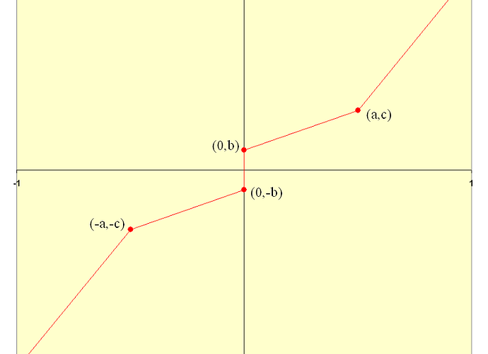

I took the liberty of parameterizing it, to make it tunable on-the-fly.
Here’s an implementation written in Delphi:
*if (x>=a) then y := c+(x-a)*((1-c)/(1-a))
else if (x>=0) then y :=b + ((c-b)/a)*x
else if (x>=-a) then y := -b + ((c-b)/a)*x
else y:= -c + (x+a)*((1-c)/(1-a));
The above connects the points (-1,-1), (-a,-c), (0,-b), (0,b), (a,c), and (1,1) with straight line segments.
The three parameters are a, b, and c:
  • “b” is the y-intercept (inverse deadband), and
  • (a,c) are the coordinates of the point at which the slope changes
