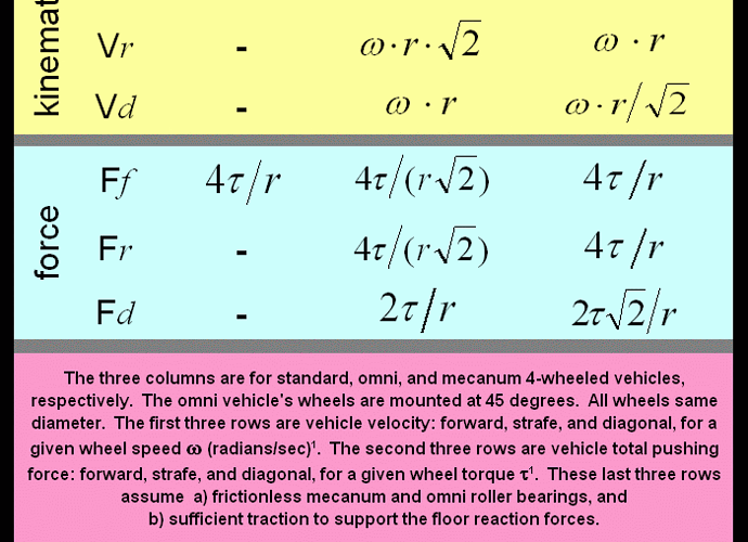

----------------Omni vs Mecanum Forces and Kinematics-----------------
omni vs mec forces 100627_.pdf (18.4 KB)
