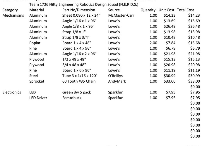

Trying something new this year…not using the template, but making our own similar spreadsheet. And not listing each part on the robot, but instead listing the items we bought to make those parts. For example, the half sheet of 1/2" plywood is only listed once, although it was used to make 7 different parts of the robot.
It’s now a Cost Accounting Worksheet, no longer a Bill of Materials. I think that means we only need to use it to account for the cost of building the robot.
We’re doing something similar. Things are grouped by what mechanism they went into, but things cut from stock that went into multiple parts are only reported once and commented. We’re also (for the first time) figuring out how much our robot would cost if we paid for the KoP and items costing less than $5 in a separate column.
