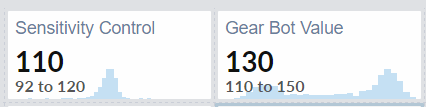

The tricky thing about this comparison is that on the surface, a few extra gears isn’t worth much (see attachment).
Yet the average difference in alliance score can be (2 to 3 per match for 3rd bot) a 55% chance of getting the 4th rotor vs (4 to 6 for 3rd bot) a 97% chance of getting the 4th rotor. That is massive.
Probabilistic models were created at www.getguestimate.com. I added a link to my signature.
