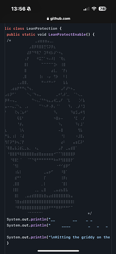

A little off topic but your “LeanProtection” subsystem is intriguing and I couldn’t help to comment on it
knowing our programmers this is quite normal for them
