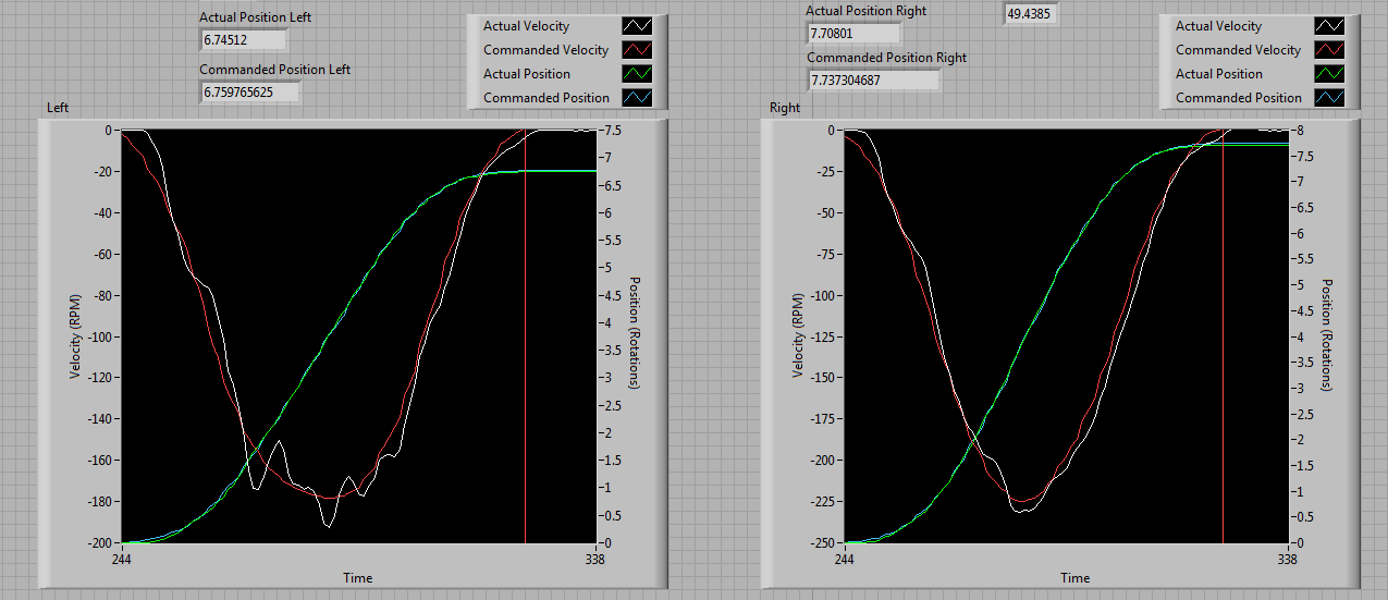

If you haven’t done so yet, plot your commanded left/right velocities against your actual left/right velocities. Because position error will accumulate over time, the control loop needs to be quite tight in keeping the actual velocity close to the real velocity.

In the talon MP, there is no feedback control on the velocity, only feedforward. The feedback control is on the position at every timestep.
I see your point exactly. Attached is a snapshot of the position and velocity graphs. For this particular run, ending coordinates were (2.96, 1.31, 49) I put an IMU on there today, so that measured heading is more reliable. I doubt we can reliably tune to better execution than this
I haven’t yet redone the path with lower max velocity…that is next.

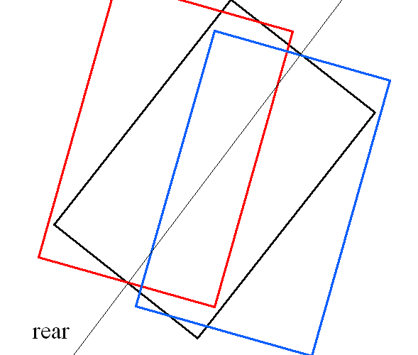

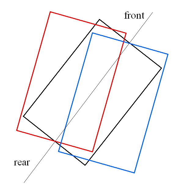

Is it dropped center?
Where is the center of mass?
Yes, drop center. I don’t know where the center of mass is.
The location of center of mass affects how a skid steer robot rotates.
Here’s an exaggerated sketch.
Red has CoM over rear wheels. Blue has CoM over front wheels.
