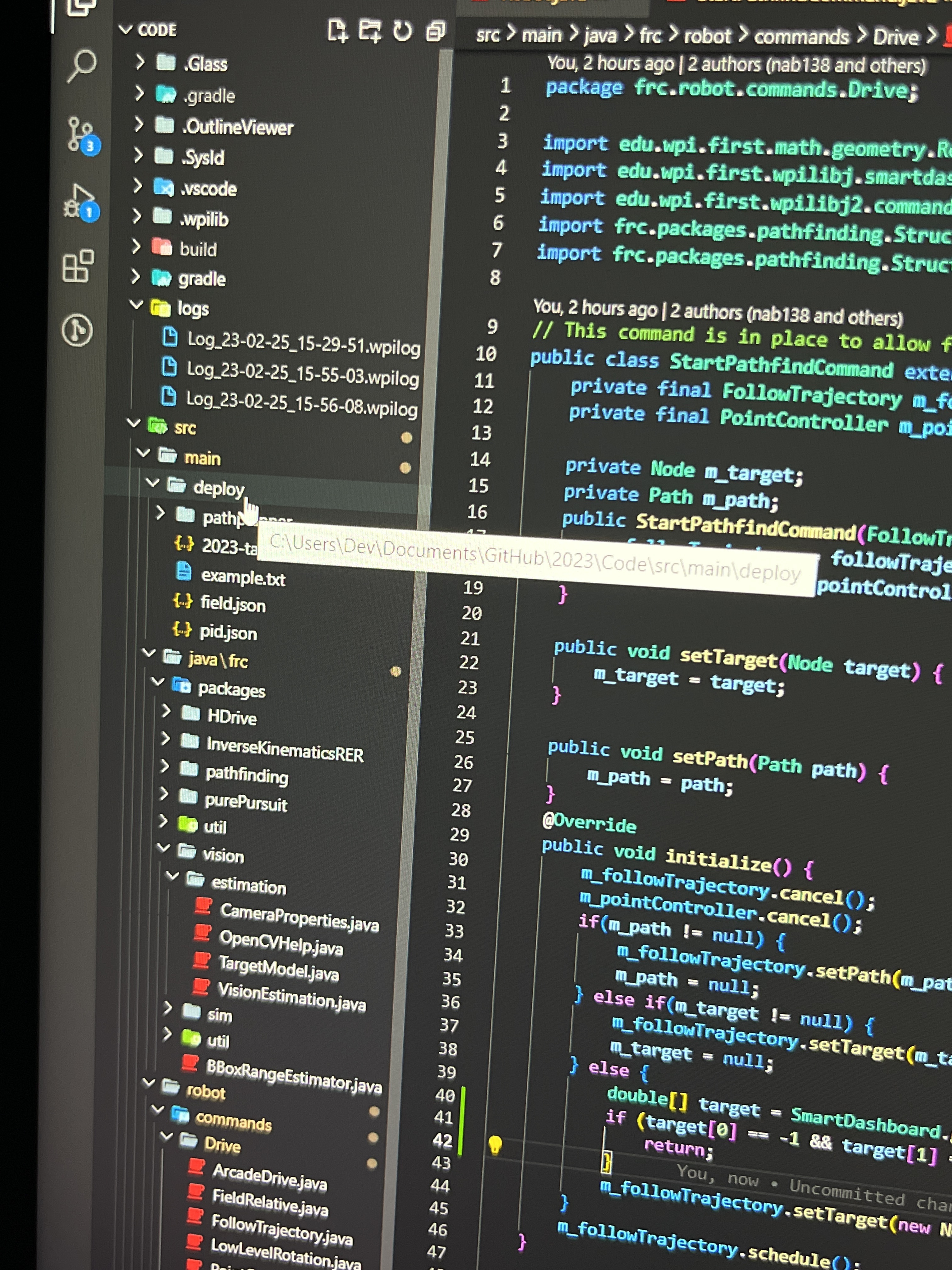

I have gone through most of the files for PathWeaver/Pathplanning/Trajectory tutorials and have gotten most of the program done it just won’t work. I’m asking if I have something wrong or if I’m missing something, I followed the tutorial in the Wpilibj documents for frc and have the code in the robot init class, I have the pathweaver path and have made it go to the folder directory that my source code is in. Am I missing something else should I put something in the autonomous init/periodic??

In general with pathweaver if you’re using the ramsete command wpilib provides schedule it in autonomous init and that should function, also make sure you have your trajectory stored in the deploy folder
A link of the code used would be great! Without code, it is hard to troubleshoot exact issues. Could you just post the auto code you use, without revealing all of your team’s code?
Yes I’m using ramsete controller and is the deploy folder in the build gradle that’s in my project?
Deploy should be following from the root src/main/deploy
Anything in it will be put onto the Rio in an identical spot making it the standard place to put json files like trajectories

When you run that are you getting a file not found error being caught by that try catch block?
No im not getting that error
Can you add smartdashboard.putData(CommandScheduler.getInstance) in robot periodic and using smartdashboard or glass see if the ramsete command ever runs
