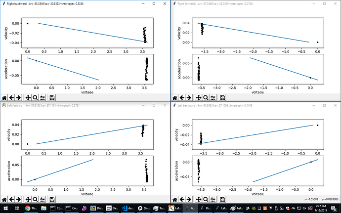

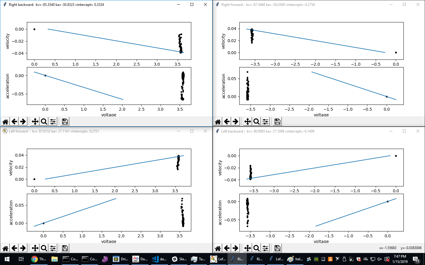

We’re having trouble getting our Ka and Kv with the RobotPy characterization tool. We’ve followed the instructions in the README, and confirmed that everything is working properly, it just seems the resulting data is completely off. It’s probably something we’re doing wrong, but we can’t figure out what.
Here’s a picture of the output, and a video of us walking through using the characterization tool.
