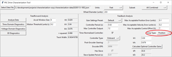

  • DO NOT use the (Talon 2020-) setting in the Characterization Tool. The max output is 1023 for Talon SRX’s. CTR did not normalize these values to [-1,1] yet.
  • Be sure to pick Velocity Loop Type in the characterization tool, not Position.
  • There are two places to enter your wheel diameter in characterization tool, be sure you enter it in both places. It goes in the Python config and in the box on the analysis page.

I did this. However, I also noticed that changing the value of the wheel diameter (or changing the units) does not change any of the values resulting from “Analyze Data” or “Calculate Optimal Controller Gains.” Which is puzzling to me.
It does seem to affect kP and kD gains when I change it.

The full story is that the analyzer wheel diameter box only affects the LQR-derived gains if you’re using a Talon with non-rotational units selected in the analyzer. We have to do this only for Talons in this certain situation because the Talons use native units internally. We’re hoping to transfer unit information from the logger in the future so that there isn’t as much confusion.
The bit of code that does this (for drive characterization) is here.

Another update: my trajectory troubleshooting guide was merged, and I changed the drive and simple motor characterization tools to find velocity gains by default.
