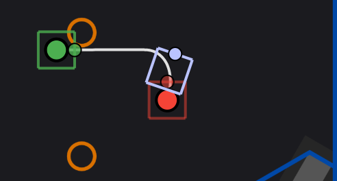

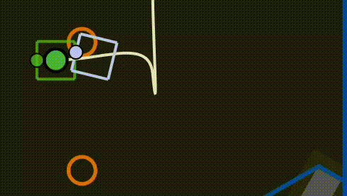

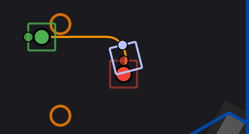

We then tried a slightly more complex path that would drive the robot forwards a bit, and then to the right, while rotating to the counterclockwise. Instead, the robot went backwards a bit, rotated to the clockwise, started going to the left, and then started accelerating very rapidly to the right, until it was disabled to stop it from bashing into a wall. The telemetry page on the PathPlanner app said the robot was following the path until the end when it started going the wrong way. I didn’t get video or screenshots of this at the time, I can try to later today, but here’s some from the PathPlanner UI that I just made:
What we wanted:

What it seemed like it wanted to do:

What it actually did:
