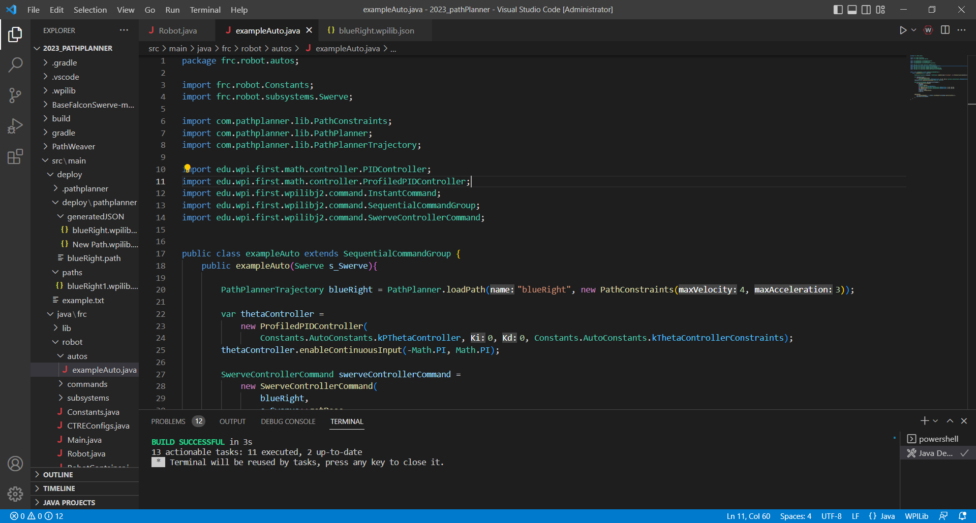

I’m trying Path Weaver, too. But it say that unable to open trajectory. Could you help me?
error codes:
  • Unable to open trajectory: paths/blueRight.wpilib.json
  • Error at frc.robot.Robot.robotInit(Robot.java:54): Unable to open trajectory: paths/blueRight.wpilib.json
  • at edu.wpi.first.math.WPIMathJNI.fromPathweaverJson(Native Method)
  • at edu.wpi.first.math.trajectory.TrajectoryUtil.fromPathweaverJson(TrajectoryUtil.java:78)
  • at frc.robot.Robot.robotInit(Robot.java:54)
  • at edu.wpi.first.wpilibj.TimedRobot.startCompetition(TimedRobot.java:106)
  • at edu.wpi.first.wpilibj.RobotBase.runRobot(RobotBase.java:343)
  • at edu.wpi.first.wpilibj.RobotBase.startRobot(RobotBase.java:433)
  • at frc.robot.Main.main(Main.java:23)
Do you know how to find your deploy directory in your robot project? If so, send a screenshot of the contents.
This?

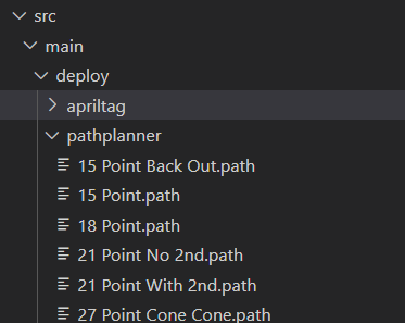

In this case, the file in the deploy directory is blueRight1.wpilib.json not blueRight.wpilib.json. For PathPlanner, you have a deploy nested inside the main deploy. You need to move the pathplanner directory up one level to get the paths to be recognized. It should look like this:
(Ignore the apriltag directory)
Oh WOW, I sucess. Thank you so much.
