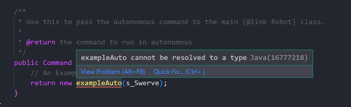

My team is not sure how to call a command in the getAutonomousCommand() section of the RobotContainer file. I’ve tried several things and searched for similar examples. We get the error in the screen shot below.

It looks like your command is called “exampleAuto” but the file it’s in is “ExampleAuto.” The names need to match, and then you can import ExampleAuto into your RobotContainer file and return a new ExampleAuto from getAutonomousCommand(). That should fix the error!
