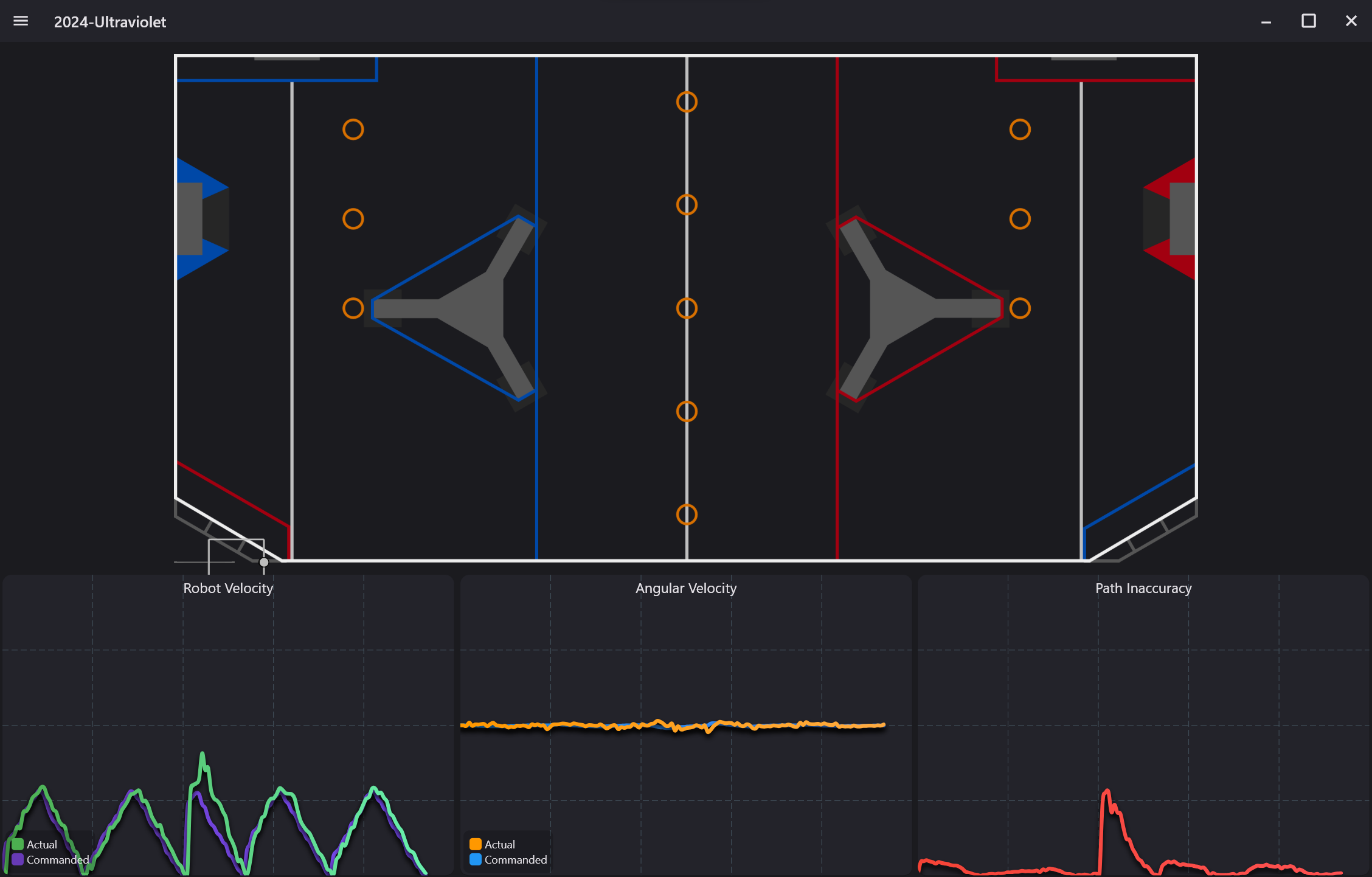

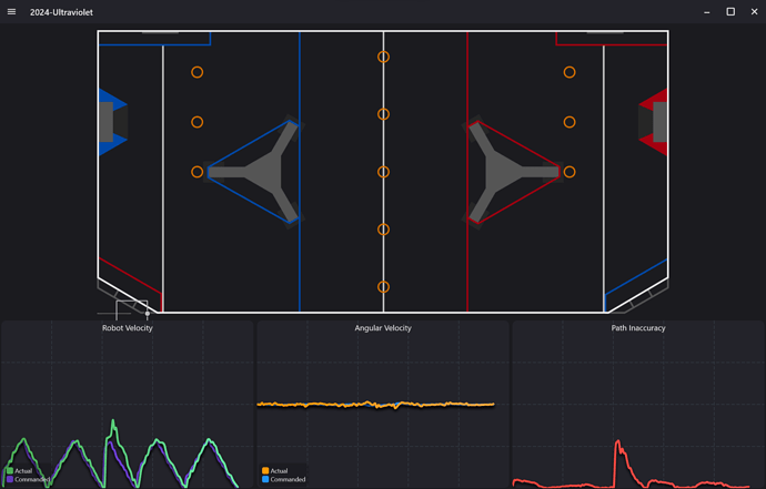

Here is a picture of the telemetry output on PathPlanner:
The middle portion of the data is when robot code was running for the first time, and the others were before or after the new code deploy.

What are the other velocities we see in your chart?

4 m/s^2 acceleration and 3 m/s velocity.

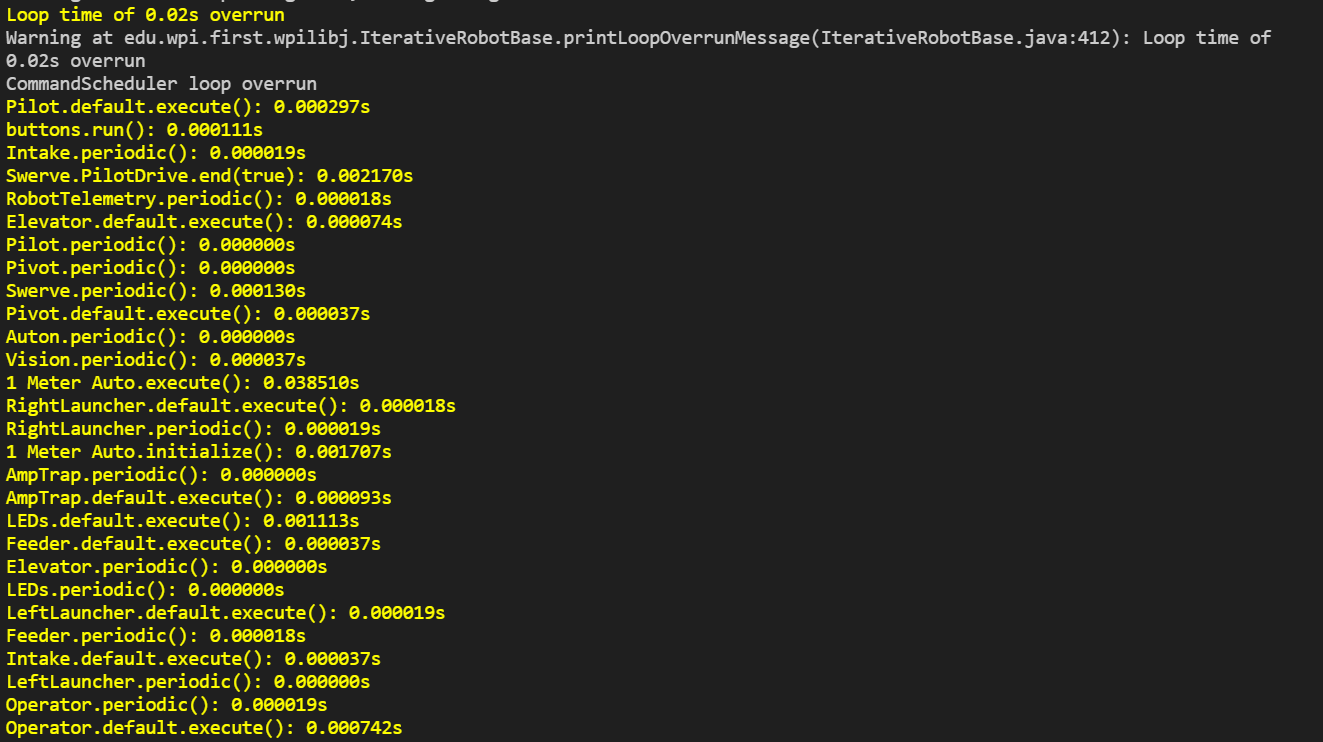

Here is a photo of our logs:
It looks like it might be a loop overrun issue with the first time autos are run (1 Meter Auto.execute takes 0.038 seconds to run, causing the loop overrun).

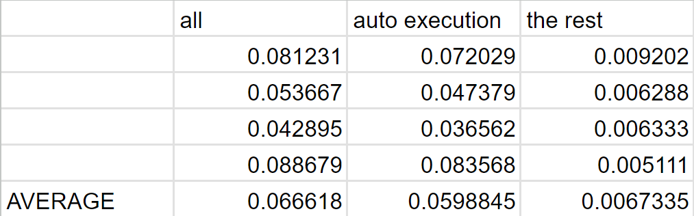

We were able to take data from our initial code and it produced similar lag every time. Here is a screenshot of our spreadsheet below (PathPlannerAutoName.execute always took the most amount of time by a significant magnitude).

Java loads classes “on demand” (the first time a function is called in a class, the class is loaded). This means the first call may take significantly longer than later calls, particularly for cases when there’s a lot of static construction or the function pulls in many other classes, such as loading json does. There’s really not a good workaround for this other than trying to find ways to exercise the code path in disabled; I was doing some work in the offseason on a (conservative) class preloader but the Rio really doesn’t have enough memory for that.
We were able to run a PathPlanner Auto in disabled and this fixed most of our issues. We also added a 0.01 second delay to our all of our Autos and it seemed to fix a small swerve delay that was also causing issues after implementing this fix.
