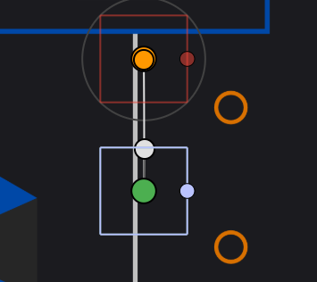

Hello! I’ve been working on my team’s PathPlanner autonomous and am facing some issues.
When given a path that looks like this:
expectedpath
the robot executes a path that is more like this:

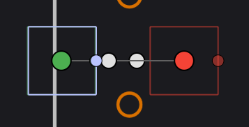

I’m unsure of how to proceed at this point and would really appreciate any help I can get. Our most recent code is here.

Your code seems to be fine. Can you show a video of what the robot does when you run the path? That may give more hints to if this is a programming or hardware issue.
As @nevadexehs pointed out, you should take a look at the Coordinate System documentation. Looking at your code, there are several indications that you’re not using the coordinate system properly. In short, PathPlanner is telling you to drive forward along the X axis, but your code drives sideways along the Y axis.
You’re not negating the joystick inputs:
double xSpeed = joy.getLeftY();
double ySpeed = joy.getLeftX();
double rotateSpeed = joy.getRawAxis(4);
You’re not negating your NavX gyro heading:
public double getHeading() {
  return Math.IEEEremainder(gyro.getAngle(), 360);
You are negating and swapping the X and Y speeds.
public void drive(ChassisSpeeds speeds) {
  ChassisSpeeds targetSpeeds = new ChassisSpeeds(-speeds.vyMetersPerSecond, -speeds.vxMetersPerSecond, speeds.omegaRadiansPerSecond);
