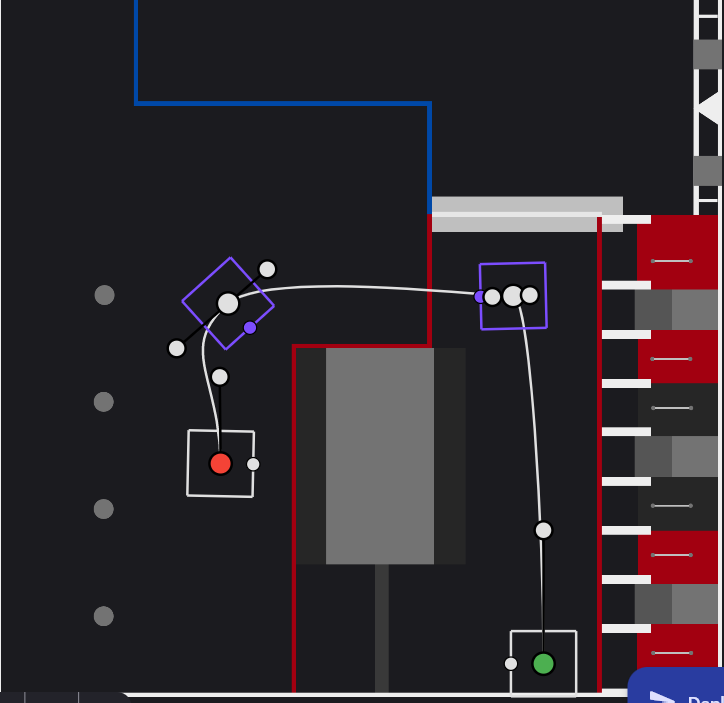

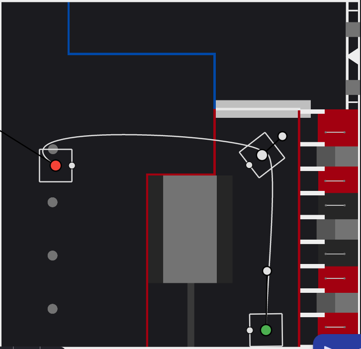

Behavior I expect:
Behavior I observe:
  • It runs a path that looks like this:
We ran the following custom paths using this method and they worked great. They got within a couple centimeters of their target consistently.

I cannot tell if my methods are bad, what I’m doing in PathPlanner is bad, my SwerveModule is bad, or what else. Any ideas what I can check?
Did you try connecting PathPlannerLib Server to see what the robot thinks it’s doing? We found this to be really valuable debug tool!
What are your pid constants for the path following command? It looks like it may be falling behind a bit.
  • kP for PathPlanner X and Y = .5
  • kP for PathPlanner Rot = .8
Like I said, we tuned these using straight paths in the X and Y and a 180 rotation + 2m movement in the x direction for rotation. Robot goes exactly where we tell it on straight paths

Because you tuned for a straight path, you might be getting a bunch of error in more complex paths. It is pretty easy for the robot to follow a straight path really well with 0 P constants since the FF will get you pretty close. It becomes a lot harder when there’s curves, momentum, module rotations, etc. to deal with.
A little example to show how little a P value of 0.5 for X and Y is actually doing:
Say you have an error of 0.1 meters and have a current target velocity of 2 m/s. Your output velocity will be targetVel + (P * error), so 2 + (0.5 * 0.1), or 2.05 m/s. If the output stayed constant it would take 2 seconds to correct for that error.
A P value I usually recommend as a starting point would be ~5. In that same example, the output would be 2.5 m/s. So it will be much more capable of correcting for error quickly.
There may be some other issues somewhere else, but I’d try giving it a go with a higher translation P and see if that helps.
I gotchya, that makes sense. I’ll adjust my P value and see what happens.
The issue I have doing that is when we had a P value that high, the robot would drive insanely off course. I had it drive a 1x1 m box and it drove across the room. I moved it back down and it was fine.
Regardless, I’ll report back.
