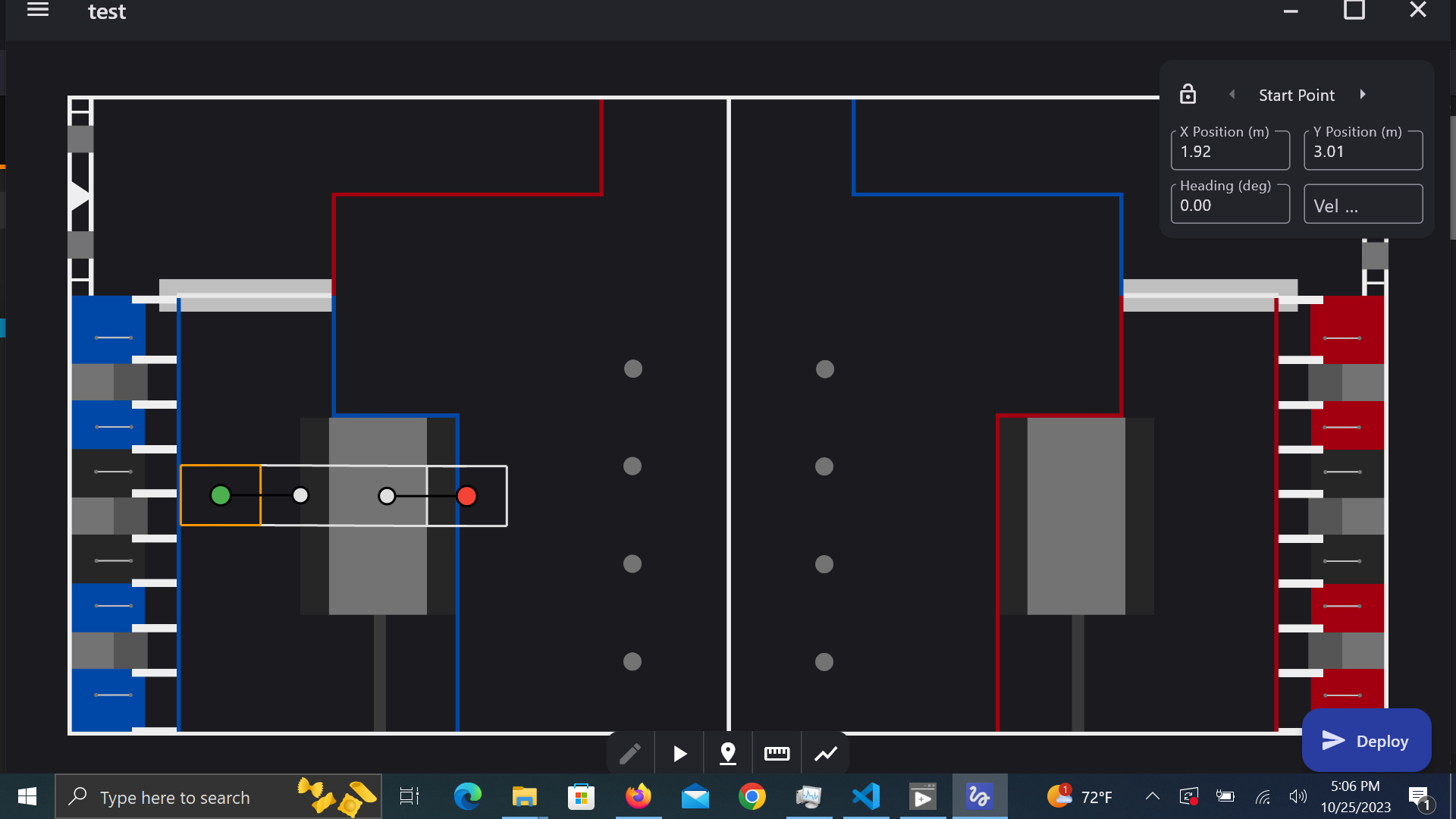

I am using PathPlanner to create an auto path, all it does is go in a straight path for 2 meters then stops. Nothing special. However, I am encountering an issue with finding the path file.
I have already configured AutoBuilder (ramsete controller), and in my RobotContainer class I have this code that follows the path:

However, when enabling autonomous mode, i get this error. It appears that the program can’t find the pathplanner path, and throws an error. I’ve doubled checked my pathplanner program; I have the right path and I’ve opened the correct project.
java.io.FileNotFoundException: /home/lvuser/deploy/pathplanner/paths/test.path (No such file or directory)

Here is a screenshot of my pathplanner with the test path opened

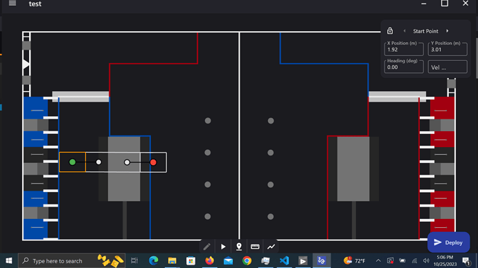

and here is my project
I’ve also clicked the deploy button a couple times, but it always fails. So i deployed using vscode.
I think I’m doing something wrong with the pathplanner program, but I don’t know what the issue is here?
Thanks for any help.
I’m not experienced at all with PathPlanner, but this is a very generic solution. Have you confirmed that test.path is actually in the directory that you’re looking in?
No, test.path, nor any other path files are in any directory in the project
That’s a problem
You’re using the 2023 GUI with the 2024 PathPlannerLib beta. These are not compatible. You need to use one of the beta releases
