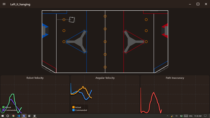

Our pathplanner is working somewhat in the rough way but it seems as if the PID is not tuned exactly, however in teleop and FRC web components our module PID is tuned perfectly.
it seems like the robot is not exactly following the commanded trajectories.

Yup, indicates a tuning problem. Hard to say exactly if there’s one or multiple issues.
Work backward - for each of these, plot the desired and actual values, and make sure they track well. Stop and fix the tuning on the first one you find issue with.
  1. Module Azimuth Angle
  2. Module Wheel rotational velocity
  3. Holonomic drive controller X position
  4. Holonomic drive controller Y position
  5. Holonomic Drive Controller Z angular rotation
The plots you showed ultimately say one or more of those has issues, but it won’t be clear which one until you walk through each one by one.
