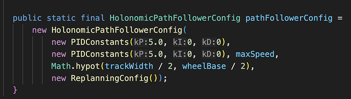

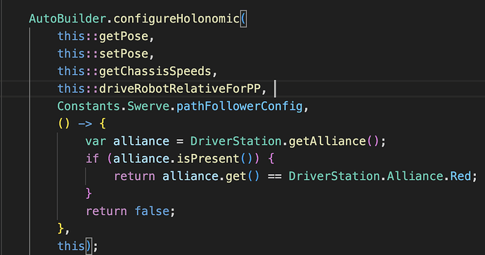

However, when we run the path on the robot, the path is executed, but then the robot makes a wild 180 degree turn at the very end of the path. Unsure why this is happening. The path’s starting position and ending position are identical. The only difference is that the path has a large rotation at the end.
I’ve attached snippets of the pathplanner code implementation below. Any guidance would be greatly appreciated.

^Code setup

It’s very likely there’s nothing wrong with your Pathplanner setup. YAGSL used to have this issue. It’s potentially caused by it automatically swapping back to the default command (Teleop Drive) after it finishes the path.
Any idea on how to resolve this? The PathPlanner setup only commands the drivebase robot relative, so I’m a little bit confused on the swapping you’re talking about.
I believe that @Technologyman00 is refering to once the Auto ends, the robot runs it’s default drive command, which may be turning it to a certain heading.
Might be worth trying just the Auton period, without teleop, if you can. Or disabling your default drive command to see if the issue persists.
Look into test mode for isolating certain commands (Like only running your auton command, and no drive command)
It would be helpful to run it with PathPlanner attached. What does the “ghost robot” do? This helps you know what PathPlanner is doing.
