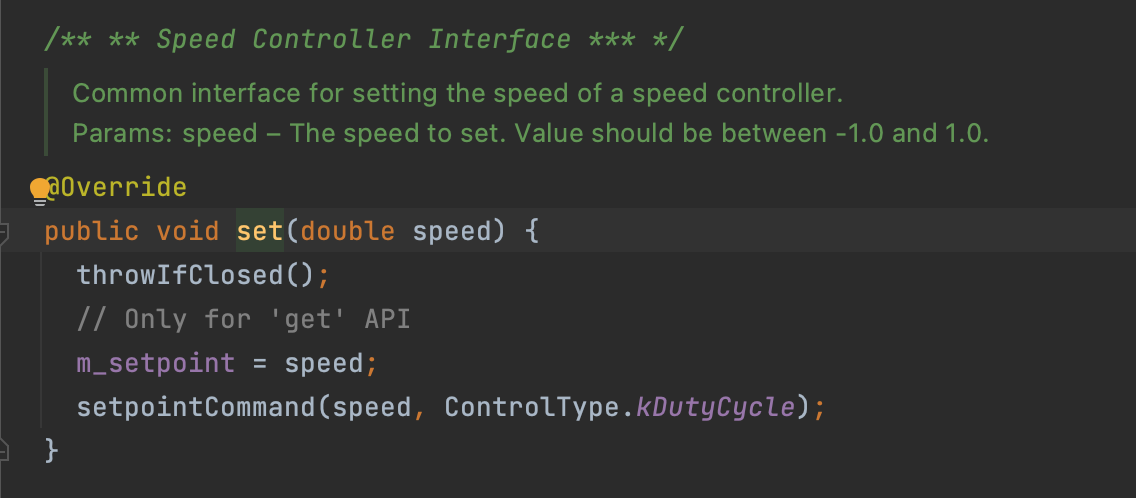

One issue I see is that you are using .set for the CANSparkMax drive motors but passing in meters per second instead of the parameter that it accepts, which is percent output in the range [-1.0, 1.0]
