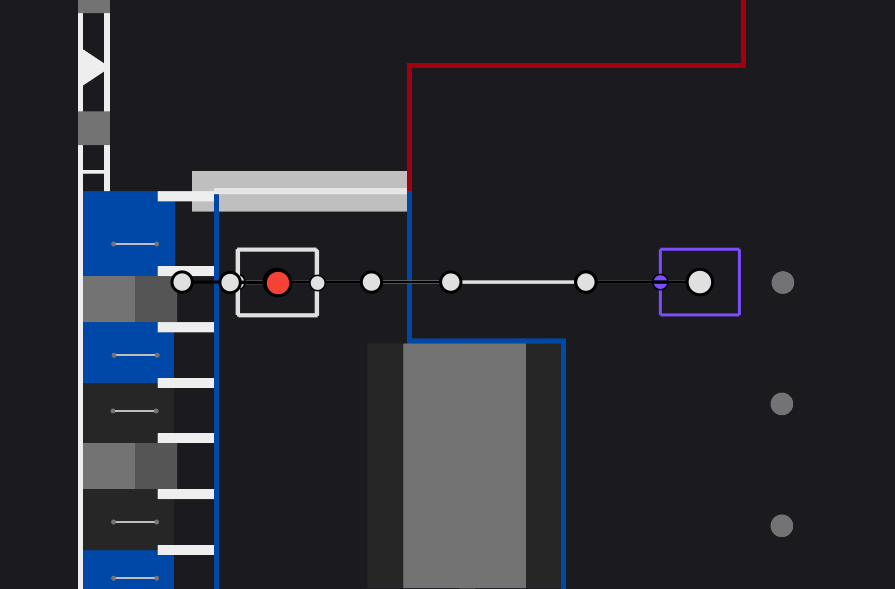

We are using the pathplanner 2023-4.2, in the example shown, our robot should just rotate 180 degrees like the photo below.
However our robot rotates more than the degrees and kind of rotates back and forth to its final point. (it is pretty inconsistent and has errors of roughly +/- 5 drgs)
On top of that, translation has shown to also be an issue. We have tuned both the rotation an translation pids and they have shown little no no difference. Pathplanner believes we are driving to this position:
(I cannot add a second embedded image, however it is just a straight line)
However in reality it goes much further
We have tried small (0.25)-extremely large pid values for each. We also see if we add a second way point in between to reach our target rotation earlier, it does reach it at that point, however it continues to uncontrollably rotate as it reaches the end point.
What could be going wrong? Is the PID tuning the wrong approach? We are using the SwerveAutoBuilder. Thank you for any and all help.

When we measure the distance it goes, it is often around 40-50% off. (when we tell it to go 3.25 meters, it goes around 5-6)
  • Gyro output looks right
  • Would you ellaborate on what characterizing it means?
  • Unit conversions seem fine
  • The translation PID doesn’t seem to be affecting anything, no matter what value we change it to.

Did you check your odometry readings?
At quick glance, your code seems fine.
Also, use PathPlannerServer to compare the path and where the robot think it is. This might be useful for debugging. For example, if the robot think it is pretty near the path, but physically it isn’t, it might have to do with your conversions or other factors.
Have you checked that your gyro isn’t the issue?
