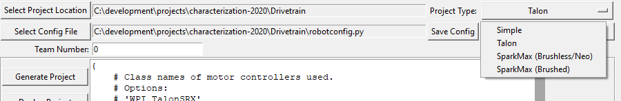

Our team, FRC 4087 Falcon Robotics, is attempting to use path planning for the first time this season. We have been able to test on our practice drivetrain, driven with Talon SRX’s, but were concerned that there is no SparkMAX option on the characterization setup. We were wondering whether or not the Spark configuration of the characterization would work for our SparkMAX drivetrain (4 SparkMAX’s driving 4 Neo’s), or if there is another way to proceed.
An additional question we had: when we initially tried to characterize the robot with the TalonSRX’s, we tried having our encoders connect to the TalonSRX encoder port (TalonSRX’s set up with CAN). However, when we tried to import the information necessary to read the values from the TalonSRX’s (getSelectedFeedbackSensor() with quadrature encoders selected). We tried to also just copy the Phoenix json into the program but to no success. Any ideas what we did wrong?
