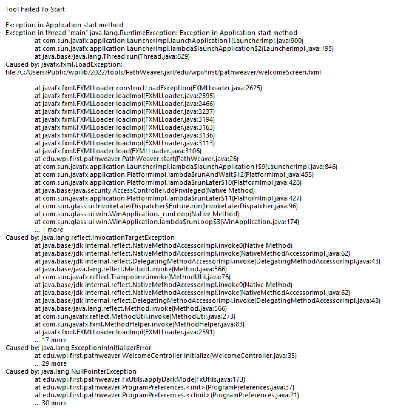

PathWeaver used to work perfectly. However out of the blue it won’t let me build it anymore. Anytime I click on PathWeaver through the start tool I recieve an image that looks like this:
Someone else had this error on Chief Delphi and I tried to solve it that way (replacing the 2022 json file and png) but I still get this error
Can you provide us a little more information about your system (OS?), what version of WPILib you have, and what changed between the time you could and could not start PathWeaver?
I’m using Windows. I’m currently on 2022.1.1 and I haven’t done anything to modify the project it just stopped working

Just upgraded to 2022.3.1 to see if that resolved anything. It did not. The project doesn’t even launch now.

I’m getting an error that says “A game already exists with the name Rapid React” when I launch from the tools folder
do you have a pathweaver project already named Rapid React from a different version of pathweaver?
