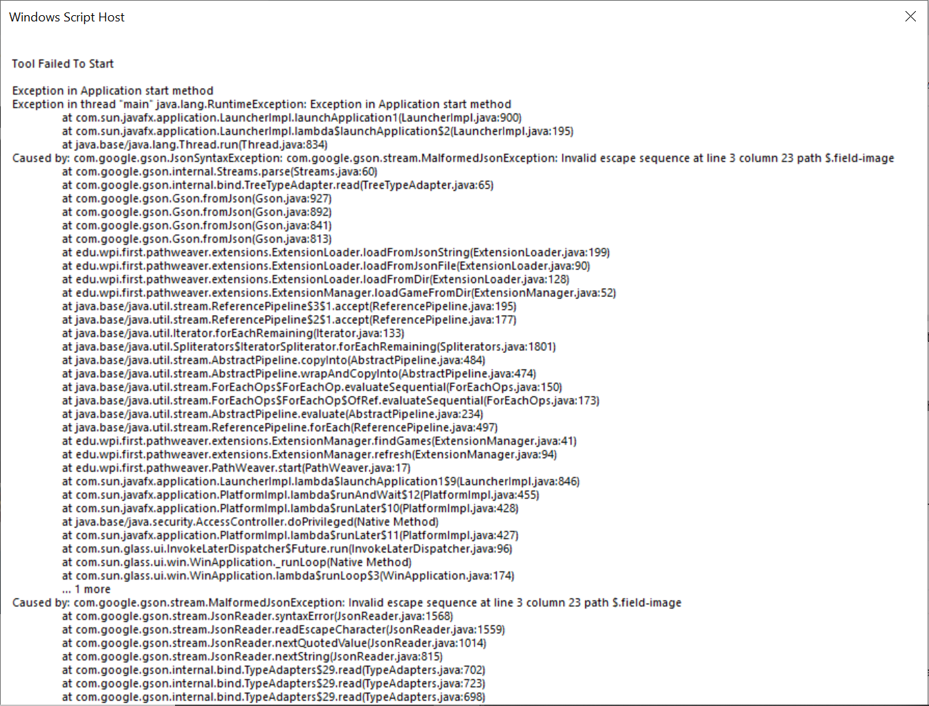

Hello everyone,
I’m trying to open up PathWeaver, but I keep getting this JSON error when I open it up. I’ve looked through my PathWeaver folders/files, and I can’t seem to pinpoint the problem; I can open up all other WPILib Tools (RobotBuilder, OutlineViewer, etc.), but I can’t open up PathWeaver. I’ve tried opening up the PathWeaver versions from previous years too, and they did not open either. Here is a picture of the error I’m getting
Any help would be much appreciated! Thank you!

Are you adding field images manually? Looks like an error in one of the game json files.

Found the problem! It was an error in one of the JSON files like you said.
When we copied the file path of the image, it copied using single backslashes, so it looked something like C:\Users\myuser\PathWeaver\Games\2021Field\2021Field.png
We realized that we should have been using double backslashes or a single forward slash and instead and changed it to C:/Users/myuser/PathWeaver/Games/2021Field/2021Field.png
It works perfectly now!
