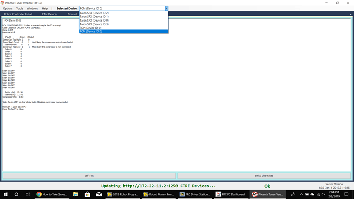

Use Tuner’s “Self Test” to find out.
This is what it shows with the robot disabled.
I think it says it right there: “Most likely the compressor output was shorted”.
But it’s a sticky fault which means it happened before but not right now (as the now column is 0).
That could be the reason for the red status.
