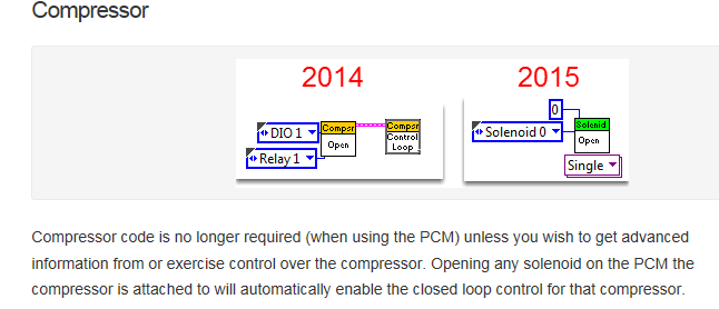

How do I do this in LabView?

That reminds me, I forgot to put the compressor loop in my code. I’ll screenshot it when I figure it out.
You put this code in Begin.vi.

With Labview, all that is needed to run the compressor is to open a solenoid object in the begin vi. The compressor vis are used to run the compressor on the older cRios.
Then why did they leave it in there when they removed cRIO support? was that a miscommunication between NI and WPI?
The old compressor control vi’s are only used in the rare case where you want to be able to shut the compressor off rather than let it automatically fill the pneumatic storage tanks whenever they are low.
For instance, when you are in a pushing contest and you want every milliamp of power available to the drive CIMs, or you detect a near brownout condition and you want to disable pneumatics before some other mechanism.
