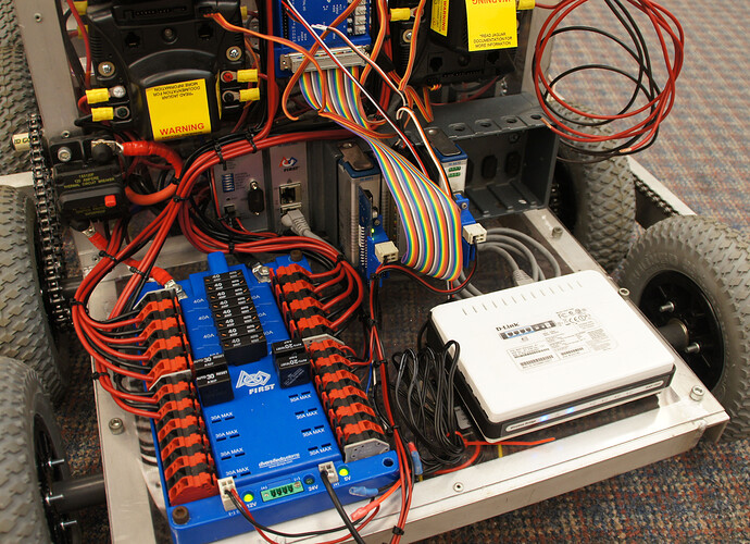

The 24V ports on our PDB keep dying. The green LED stops lighting up after seconds of running our robot. So far we have 3 broken power distribution boards…:mad: An ideas why?

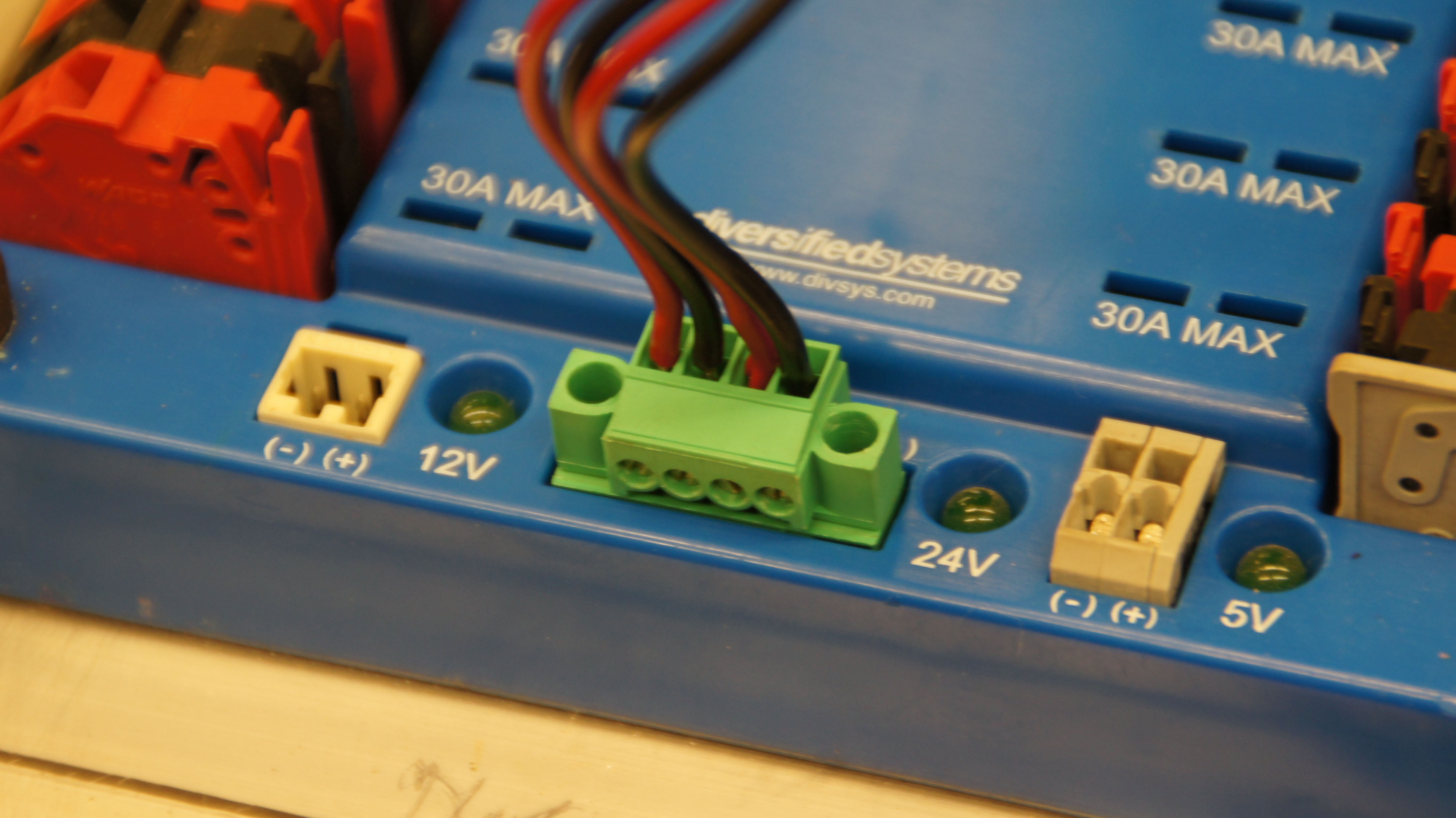

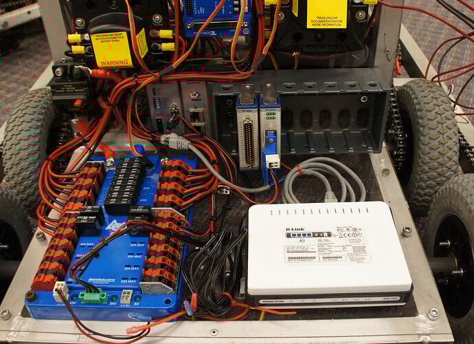

heres a picture
nope not getting shocked.
Garten, I’m very confused by several of your responses in this thread. Do you have data to support your claims that Lexan can conduct electricity 4-6 inches and that the voltages on the robot are sufficient to cause noticeable electric shock?
Jsasaki, verify frame isolation with a meter. Then, check the insulation on the wires coming off the right hand side 40A breakers - you may be shorting there.

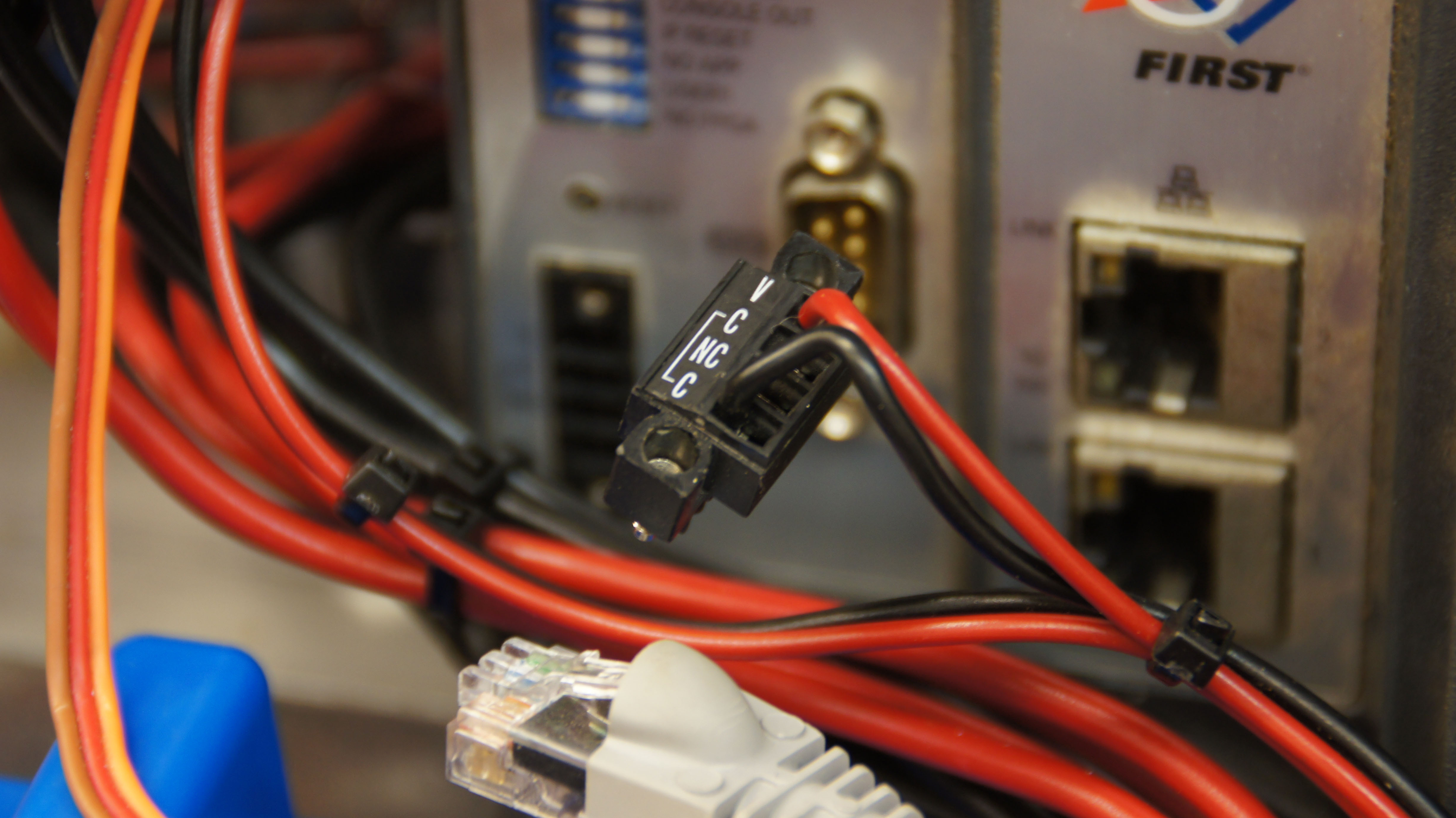

It would be nice to see the other end of the four pin connecter.
Also, those wires touching the Crio from the jag in the upper right corner at touch the Crio and those are getting power.
Looks to me like the wire on the 5 volt camera plug is a little long… Either that, or it’s something blocking my view…
Yea I saw that too.

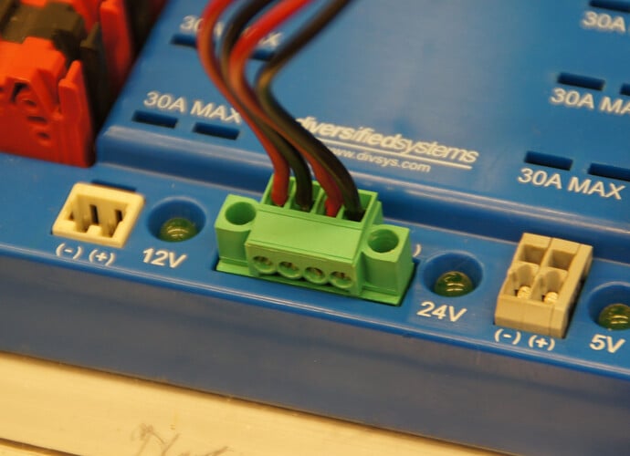

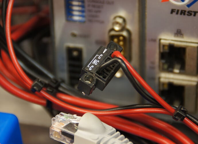

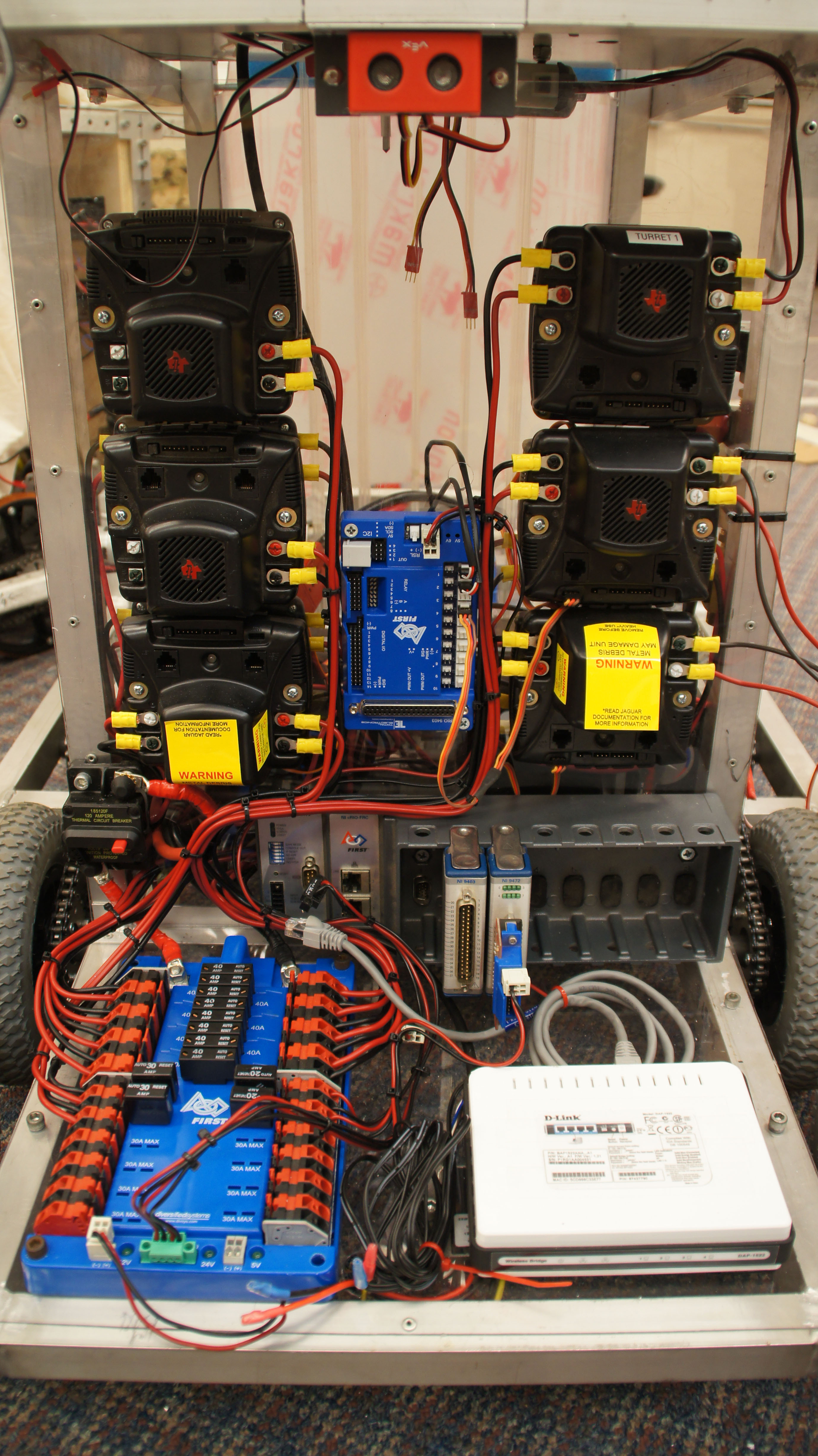

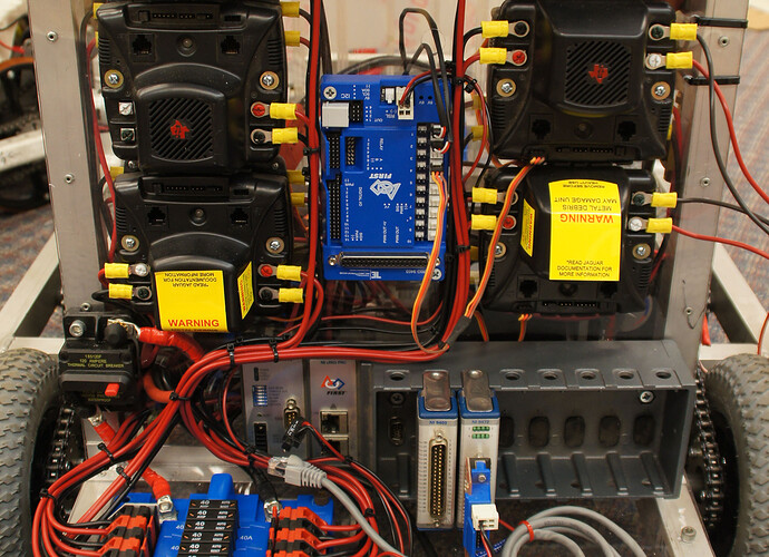

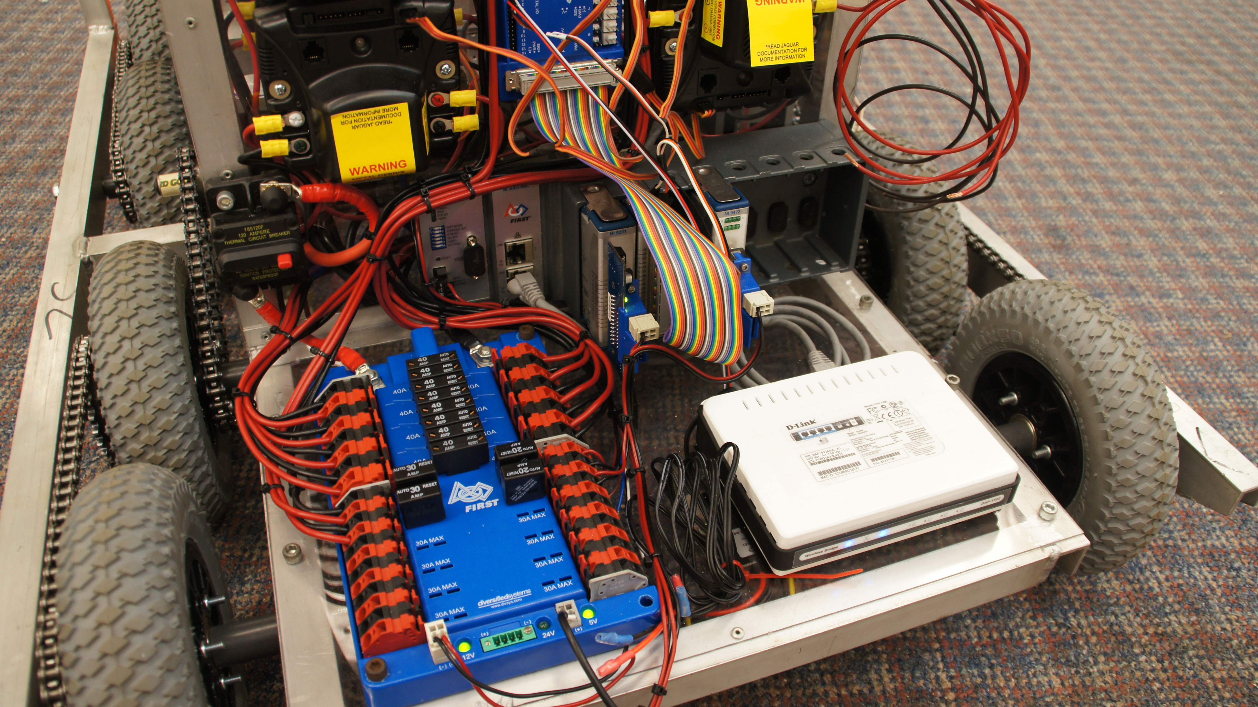

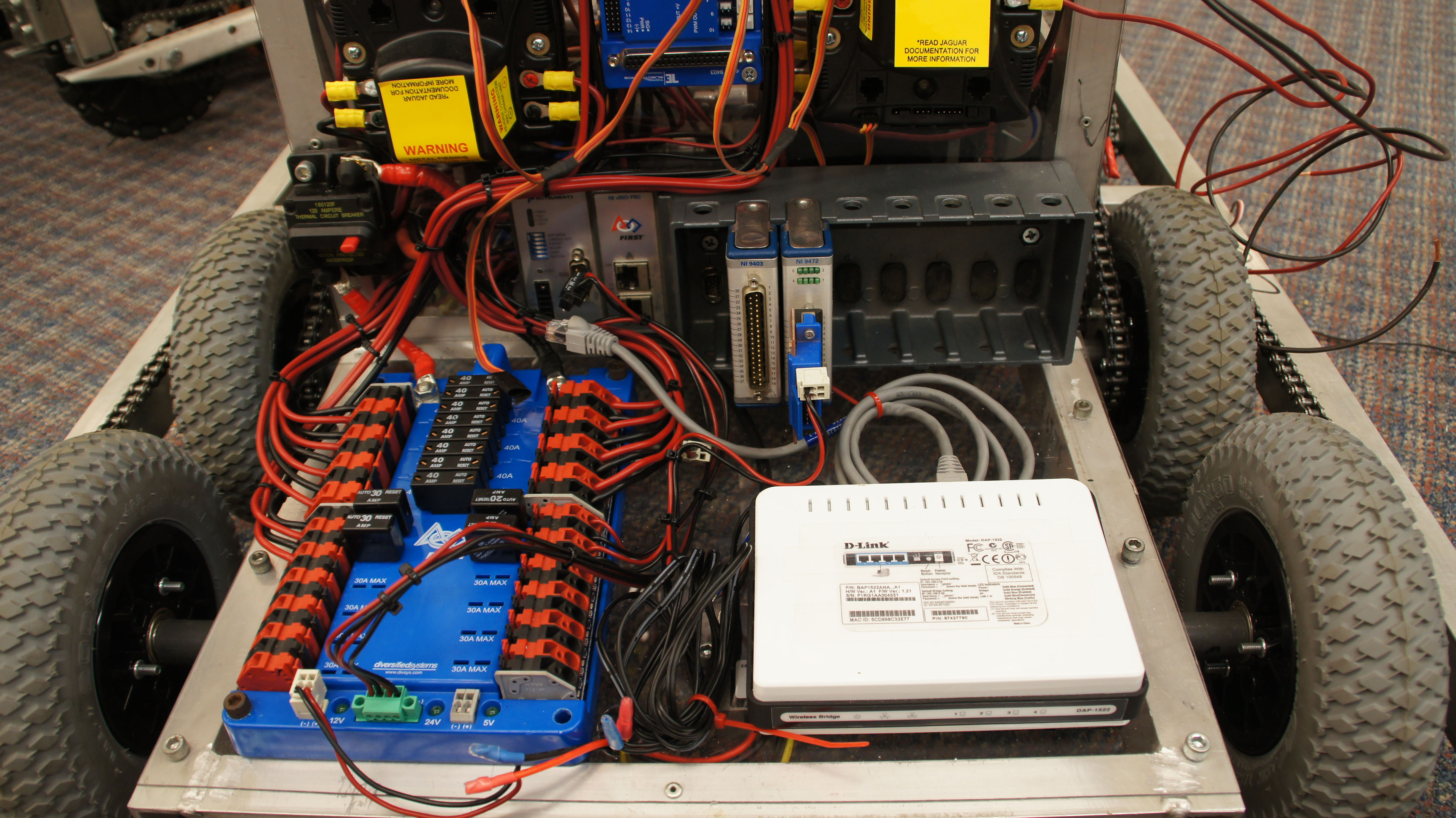

more pictures
In the 24v connector on the PDB, there are four wires connected. Only two should be connected. I see that there are only two wires on the CRIO end. Where are the other two going? It looks like it might be the sidecar. The sidecar should be fed by 12v on a dedicated 20A breaker.
I just looked again and it looks like the second set of wires is going to your analog breakout. That should also be powered by a dedicated 12V 20A breaker.
The second set of 24v wires feeds the solenoid breakout (properly).
